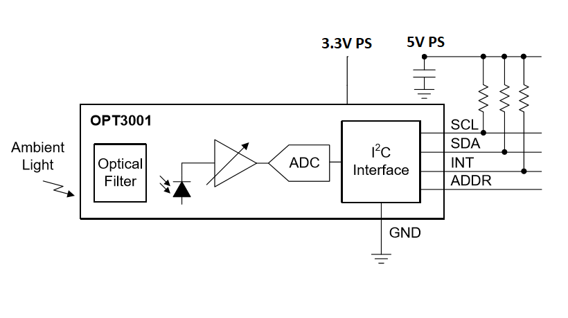

Dear, Sir.
My customer is evaluating OPT3001-Q1 for their system, now.
They are making several questions as below.
Please give your advice.
1. They will supply 3.3V for OPT3001-Q1 and 5V will be supplied for
  I2C pull-up bias source. I suppose this kind of usage will be no problem
  because this device has "5.5V Tolerant I/O", but I would like to double-confirm
  this. Is it no problem?
2. 3.3V will be OFF at system sleeping. 5V will continue to be supplied.
  Is it no problem? They are concerning as the device break-down due to this
  condition.
