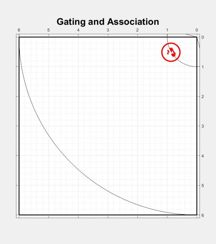

Hi all,
I am working on people count demo using IWR1642 boost. I created boxes as shown in demo video. I want to know whether the person is coming in or going out of the box without the GUI. I am trying to find this out with the help of velocity parameters.
Is there any judgments in velocity parameters like,
i. If a person is moving towards the sensor, will the velocity be in positive? and vice versa
ii. Will the velocity sign (+/-) will help in finding the movement of the people towards or away from the sensor?
If not, suggest some parameters which i can look into for finding the motion of people towards or away from the sensor.
Also , i want to know what are the best range of azimuth angle tilt values we can keep the sensor to get the best accuracy of people count in a room of about 6 meters.
Thanks in advance,
Ha An
  • Hi Ha An,
    1) Velocity of the tracked object is split into two components - x velocity and y velocity. When X position or Y position are increasing, the respective velocity values are said to be positive. So positive Y is moving away from the sensor, and positive X is moving to the right of the sensor (when facing same direction as sensor).
    2) The Sensor is positioned at (0,0) in Cartesian space.  The target is approaching the sensor if position + (velocity*time_step) are approaching zero.  For example, assume the target is at (2,3) and has velocity (-0.5, -1). In the default configuration, each frame is 50 ms. Not accounting for acceleration, next position of the person is X = 2 + (0.05*-0.5) = 1.975 and Y = 3 + (0.05*-1) = 2.95. So new position will be (1.975, 2.95), which is closer to the sensor, so you can say the target is moving towards the sensor.  However, if velocity was the same but original position was (-2,-3), the new position would be (-2.025, -3.05), which would be farther from the sensor so the target would be moving away from the sensor.
    3)  The recommendation is to always have the sensor at 2-2.5 m with an down-tilt of about 15 degrees.  When placed in a square or rectangular room, I recommend putting the device in a corner, as the devices field of view is 120 degrees, and when in the corner, the whole room can be covered with a 90 degree field of view. I recommend starting with the default configuration, then changing the scenery parameters to meet the dimensions of the room. Remember to change the angle in trackingCfg as well - trackingCfg 1 2 150 20 200 50 90 - the bolded 90 will need to be changed to 45 or 135, depending on the direction of turn, explained in the Customization guide, page 7.

  • Hi Ha An,
    The GUI will overwrite the tracking config parameter in the config file automatically when you send the configuration.   So your method is correct.
    Please note that this really just changes where the sensor bore-sight (0 degree azimuth) appears in the GUI. If you change the angle to be 20 degrees, the bore-sight will move by 20 degrees.  The goal with this feature is to allow you to better visualize the room.
    For example:
    Put the device in a corner, at 45 degrees to either wall. Set the angle to 45 degrees, and set the Scenery parameters to reflect the position of the sensor.  Now the graph in the GUI will better represent the area.
    Justin
