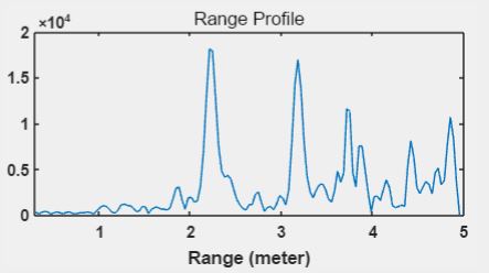

I'm trying to get the person's vital int the room using VitalSignDemo of IWR 1443.
From the RangeProfile (attached below) in the unattended room, I can see that the clutter is on it.
Does Demo have a mechanism to cancel clutter?

Ceaser, Thanks for the reply.
We have confirmed that we can acquire signals sufficiently in the range of range profile initial setting ~ 1 m.
What I really want to hear is "clutterRemoval" in P22 of mmwave_sdk_01_02_00_5 \ docs \ mmwave_sdk_user_guide does not work with VitalSignsDemo in IWR 1443?
There was no change even if adding the following to the "profile_2d_VItalSings_20fps" (Configration file for Vital Signs Demo).
ClutterRemoval -1 1
