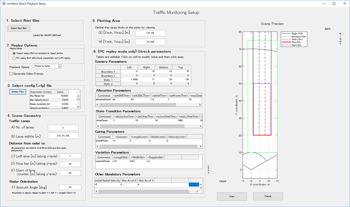

    C:\ti\mmwave_industrial_toolbox_2_4_0\labs\lab0013_traffic_monitoring_16xx\src\mss\gtrack\test\win\matlab\mex\gtrack_create_mex.c L210
    if (mxGetN(field) != 1+4*config->advParams->sceneryParams->numBoundaryBoxes+1+4*config->advParams->sceneryParams->numStaticBoxes)
    mexErrMsgTxt( "Scenery Parameters wrong unumber of inputs");
    "MxGetN (field)" on the left side of the IF statement is 18.
    The basis of "18" can be found from the following code.
    C:\ti\mmwave_industrial_toolbox_2_4_0\labs\lab0013_traffic_monitoring_16xx\gui\setup_replaygtrack.m L62
    handles.box = struct('numBoundary', 1, 'boundaryBox', [-2 15, 10.0, 75.0; 0, 0, 0, 0], 'numStatic', 1, 'staticBox',[1.25 11.0, 20.0, 50.0; 0, 0, 0, 0]);
    But, "1 + 4 * config-> advParams-> sceneryParams-> numBoundaryBoxes + 1 + 4 * config-> advParams-> sceneryParams-> numStaticBoxes" will be 6.
    Explanation is as follows.
    'Config-> advParams-> sceneryParams-> numBoundaryBoxes' will be 1.
    'Config-> advParams-> sceneryParams-> numStaticBoxes' will be 0.
    Therefore,
    1+4*1+1+4*0
    =1 + (4 * 1) + 1 + (4 * 0)
    =6
    Since 18 and 6 do not match, an error occurs.
    "6" on the right side is obviously wrong.
    Why will it be "6"?

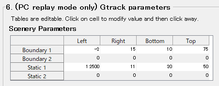

    The "Scenery Parameter" set is as follows.
    Notice that 'Boundary 2' and 'Static 2' are all 0's.
    This setting is passed to gtrack_create_mex.c with the following data array.
    [1, -2, 15, 10, 75, 0, 0, 0, 0, 1, 1.25, 11, 20, 50, 0, 0, 0, 0]
