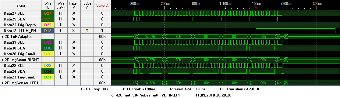

  • Suramya, with the help of my colleague I was able to get a scope probe attached directly to R108 (10k) on the SB, activate the test-software and catch that VD_IN trigger signal with the scope. This is as good as it gets I guess. I can confirm that we have a clean trigger signal there. It shows similar data as the logic analyzer (measuring at the PMOD-connector on the FPGA-board), namely a pulse approximately 300ns in length and a voltage comming from GND well up to 1.8V quickly. This is proof that the intended and well formed trigger pulse most likely enters the OPT9221. Yet, the TG is ignoring the external sync-pulse. If I instruct the FPGA trigger module to give no pulse and start all my sensors (2x2D and 1xToF) then only the ToF delivers data! There must be something I am overlooking and it is most likely with the programming of the OPT9221. I have also checked that the TG was in stopped mode (0x80 had value 0x000001) before programming the TG:0x81 register. It could have been that the sync mode must not be set while the TG is in operation. But I confirm that TG is not in operation when it is programmed for sync_mode.
    Regards, Frank.
  • Frank,
    I meant sharing VD_IN as well as the ILLUM_EN signal together on the scope. We need to verify if the EXT_VD_IN is doing anything to the capture of frames, which is why I wanted to see both the signals together.
    Also, share all the register dump from OPT9221, while in slave mode.
    Suramya

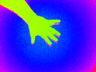

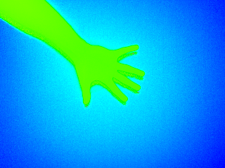

  • Suramya, sorry for providing not all the data. The Attached images contain captures of both signals at once. The upper curve (Ch1) shows the VD_IN signal. The lower curve (Ch2) shows the ILLUM_EN signal (J1, pin1). Since the trigger-pulse is so short in comparison to the illumination enable signal, you cannot spot the VD_IN pulse, although it is there. Hover on my scope controlls I can see that triggers are picked up on Ch1. I attach two different time scale images. Also attached is a register dump of all DE and TG registers (flat address dump). Please let me know if I could provide further data that helps resolve the issue.

  • Suramya, I have modified my Application to not activate the trigger module. Now we come to what I have reported initally.
    (1) The EXT_VD_IN puse will not appear (FPGA trigger is off)
    (2) The slave_mode is programmed into the TG and the TG is started (I have kept the I2C-sequence)
    (3) I have to set my scope trigger to Ch2 otherwise I would not see what is going on on the ILLUM_EN line. Then I can see that the pulse train on ILLUM_EN is visible just as if no slave_mode would have been programmed into TG. This matches my observation that only the ToF sensor delivers data in this case (Interrupts). The other imaging sensors are silent as expected.
    You say you cannot reprodruce the behaviour I am observing. How are you providing the external trigger to the SB?
    I have recorded I2C signals together with ILLUM_EN and EXT_VD_IN (Trig-Depth) now:
    what can be seen is that the ILLUM_EN pulses get going as soon as the last byte is written to TG:R0x80. What is not displayed here is that TG:0x81 is written with 0x0000A1 just before that. You can see I2C signalling towards the other sensors too but they are not answering having different device addresses.
    Regards, Frank.
  • Hi Frank,
    This waveform is not expected. With slave_mode turned on, you shouldn't see any signal.
    I'm providing the external trigger using a signal generator. For triggers. I'm using a 100ms signal. When OPT9221 receives a signal, illum_en is giving signals. Otherwise, no signal is seen.
    Are you using the latest firmware? This can be found here: www.ti.com/.../sbac142
    Have you made any modifications to the OPT8241-CDK-EVM?
    Suramya

  • Hi Suramya,
    Thanks for answering.
    The output data is in contiguous mode.
    I have attached 2 phase images. The "good" one is with the controller configured with the sequence provided by Nithin Jose so with the slave mode configuration done after his configuration sequence and so with the slave mode not working. And the "bad" one is with the slave mode configuration done at another place in the sequence so the slave mode is now working but the phase image is weird. And this image is typically the kind of image we get if we don't scrupulously comply with the configuration sequence given by Nithin Jose.
    Correct phase image:
    Wrong phase image:
    Corentin
  • Corentin,
    Do you put the device in slave mode after or before intg_duty_cycle is updated? Please put the device in slave mode before updating intg_duty_cycle.
    Or else, update intg_duty_cycle in the end and see if that resolves this issue.
    Suramya
