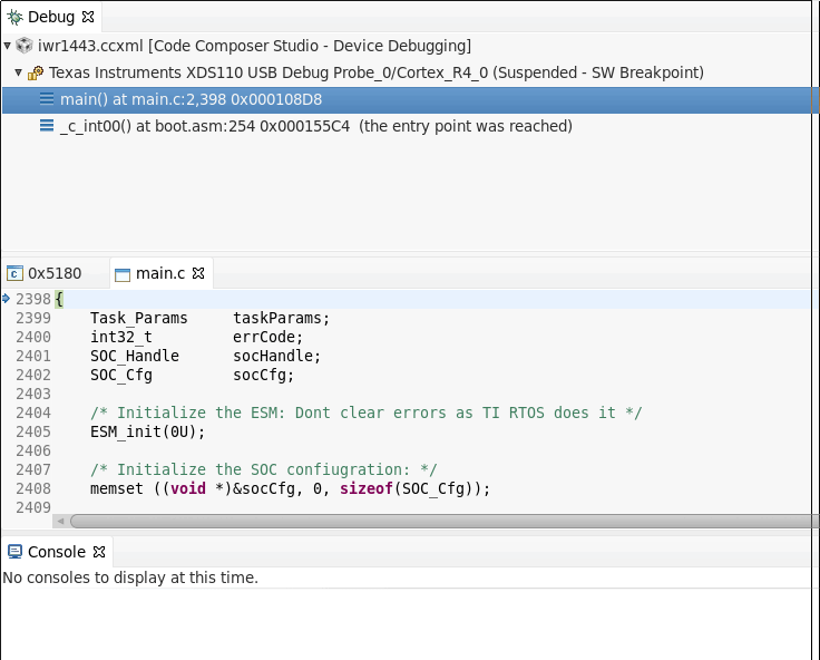

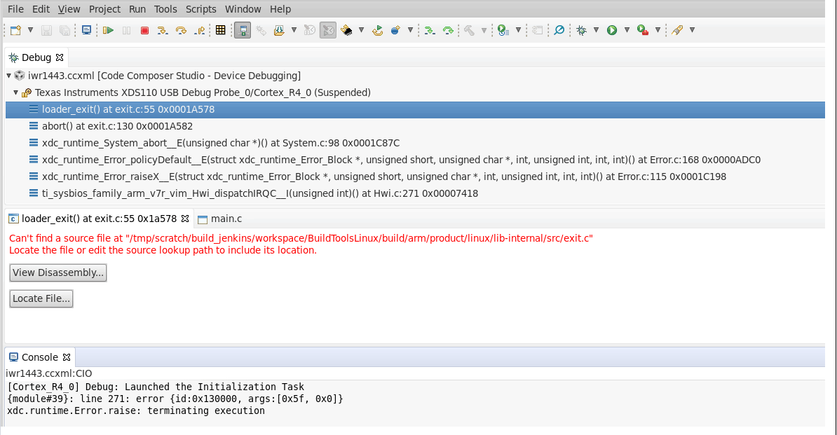

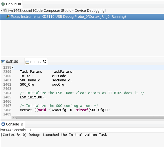

    I have been able to partially answer my first question but not completely.  I found two documents referring to ccs debugging.  One was 6153.mm_user_guide.pdf and the other ADC Data Capture SDK1.05 V1.00.pdf.  The first one provided guidance on how to connection/load and run followed by gui control.  The second document indicated ccs debugging with configuration through serial program (I used minicom).
    Through minicom, I was able to supply parameter and start the part on /dev/ttyACM0 and recover data on /dev/ttyACM1.  However, I was unable to obtain ccs console feedback that the CLI was operational.  I have attached three images.  The first two are from my ccs session and the third image is from the 6153 pdf source to illustrate that I did not end up with an operational CLI.  Can you please provide some guidance to me on this?
    My issue with not being able to build functional binaries still exists even though no errors or warning were generated during the build.  I could not provide configuration information via the gui or the serial port as I did above.  I would appreciate some guidance on this.

  • Hi Allen,
    It appears that you are running the Water/Ground Demo. After the "CLI is operational" command appears you should be able to freely run the demo through the GUI. Have you tried this? If unsuccessful would you be able to post a screenshot of the Matlab Console and whatever error messages might be happening?

    I built the oob demo for a iwr1443 board using CCS 7.4 on a linux platform.  The SDK version was 1.2.0.5.  I loaded the binary in the part using uniflash  version 4.4.  It did not run so I attempted a debug session with CCS.  I had no build errors or warnings during the build process.  I can load other prebuilt binaries and they run fine.  I have attached a screen image of the debug session.  It can not find a file from a /tmp/scratch/build_jenkins/.... location I do not have.  I searched for assistance on the forum pertaining to the missing file and found this posting: CCS/TMS320C6748: ccsv5.5 - can't open time.h and rand.h.  This old posting does not provide any assistance to me.
    Please advise.  Thanks.
