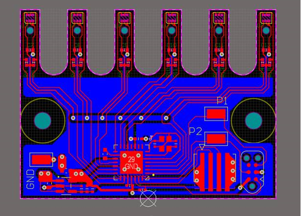

Actually we designed a PCB with 6 HDC2010 sensors to characterize the variation. Fig (1)
Also the few boards we populated was possibility units from different batches of HDC2010.

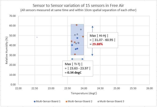

Attached are the initial scatter plots - we see (hugely) non compliant measured values  Fig. (2)
Can this amount of drift be expected from assembly mishap in your experience?

Fig(1) PCB we have used, 3 such PCBs left in free air and such that all devices measure humidity at almost the same instant.
Fig(2): Sensor to sensor variation scatter plots

    Thanks for the update. Humidity Sensors in general have to go through a strict fabrication flow to reduce any possibility of contamination that may occur during this process. The guidelines are provided in the following link, and are typically found in the product tool folder:
    www.ti.com/.../snia025
    If these guidelines are not followed, contaminates or VOCs that are common in the assembly process may impact device accuracy, as the polymer dielectric is fully exposed to the environment.

  • Hi Prasad,
    Thanks for the clarification. Yes, I believe it may be worth it to verify the fab and assembly process for your board. The document I've mentioned in the previous posts should help, but I would like to highlight main points when designing with humidity sensors:
    1. Ensure that the type "no-clean" solder paste is used when soldering the HDC devices.
    2. Board washes are not allowed after the HDC device is placed onto the board. This is especially important, as any chemical/liquid wash will seep into the sensor area and impact the performance of the sensor.
    3. The HDC device should be the last device populated on the PCB.
    4. Correct soldering profile should be used, and should not exceed 260C.
    We do have some EVMs that you can order for the HDC2010 and HDC2080 devices. The EVMS can be found at their respective product tool webpage. Please let me know if you have difficulty finding the page.
    Mat
