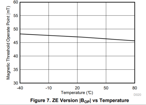

A switch type like DRV5032 does not offer consideration about temperature drift in datasheet.
If DRV5032 is used, it is not required to care about magnet temperature drift, isn't it?

    3) The temperature drift characteristics of BOP and BRP are shown in the section 7 of the datasheet, so it is possible to estimate the new thresholds at high or low operating temperatures if necessary. Also, if the operating temperature constantly changes by large values in your application then it may be a good idea to consider using a temp sensor for re-calibrating the thresholds.

    The figure of magnetic threshold vs temperature from DRV5032 shows to getting decreased threshold point as temperature increases.
    Does it mean the sensitivity of DRV5032 is increased with increasing temperature?
    Is the result of temperature compensation inside device?

    A decrease in threshold values means that less field is required to change the output state, which translates to higher sensitivity. So you are correct. Also, if you estimate the slope, you will notice that the drift in BOP (and BRP) is about 0.12%/'C (relative to nominal value in mT), which counteracts the magnet drift.
