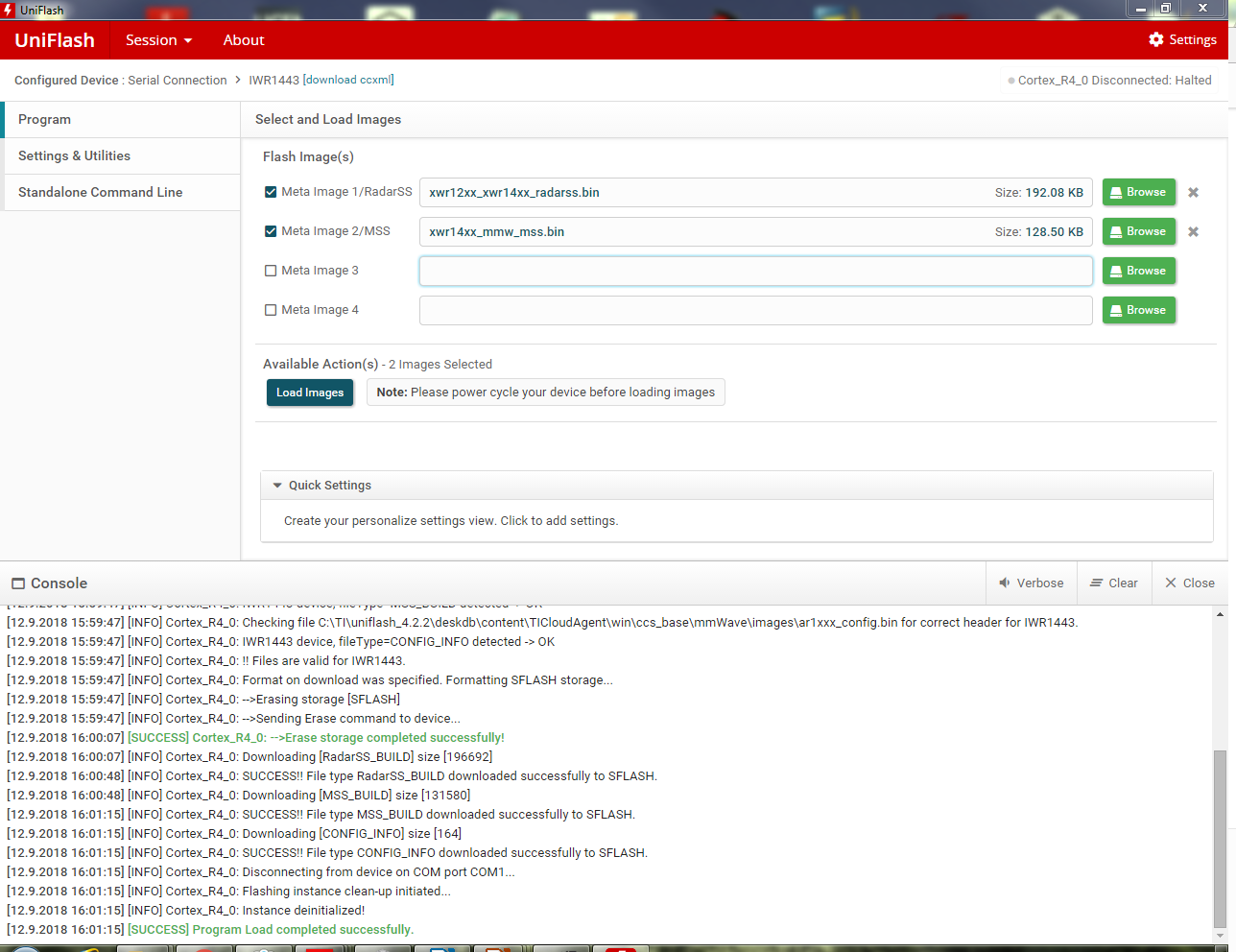

    The BSS is just another name for RadarSS. Can you send a pic of Uniflash when the xwr14xx_mmw_mss.bin is downloaded? When you are flashing xwr14xx_mmw_mss.bin to MSS, are you still specifying the xwr12xx_xwr14xx_radarss.bin in the RadarSS field? Basically I want to make sure that whenever you flash a new MSS bin file you also always specify the RadarSS bin file since Uniflash will erase the entire flash memory by default including any previously flashed RadarSS bin file.
    John
  • Hello John,
    here the pic after everything is flashed.
    The radarss.bin is staying in the Meta Image 1 field when I flash a new mss.bin file. I think this is okay because the radarss.bin isn't always changing like the mss.bin file.
    I have also tried it specifying the radarss.bin when I flash a new mss.bin but no success.
    I have also tried to turn on a LED in the function which should be called when I press the button (interrupt), but also no success. (function is MmwDemo_switchPressFxn() in sensor_mgmt.c)
    When I set a breakpoint in this function of the interrupt and use my sensor with the ccsdebug_mss.bin file, the breakpoint stops the programm. -> sensor is working fine.
    Jan
  • Hi Jan,
