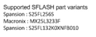

  • John,
    I just spoke with another team member, and the only reasons we think this could happen are a) the sflash is not compatible, or b) it is damaged.  Have you tried taking the working sflash from the 1642 EVM and installing it on your board?  Here is part of Figure 6 from the bootloader doc that shows the supported flash types:
  • Dave,
    You were exactly right.  I thought the cross that I had was compatible, after a thorough examination, so it must be a subtle difference.  I have the AWR1642BOOST programmed using a blank MX25L3233F.
    Thank you so much, this completely resolved my problem.  Next, I will try to burn the flash on our production design.
