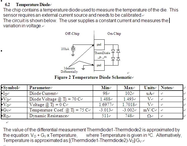

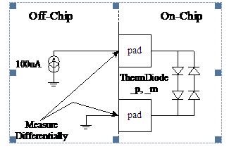

My customer wants to use TMP422 to measure temperature of series diodes. As figure 1 shows. Is TMP422 able to measure it? If so, what is the address of TMP422?
  • Hello Jeff,
    The TMP422 is designed to sense remote temperature across a single diode. The above system may not have been tested. I will need to check. Also is the 100 uA current source shown an external current source, since the TMP422 drives the current, so any external current source may interfere with the correct readings.
  • Hello Jeff,
    In my discussion with my colleague, it seems we cannot use the TMP422 to measure via 2 diodes. Let us see if there is some other configuration (which may require extra components), that can be used for sensing.

    Do we have sockets to measure via 2 diodes?
    If not, can we use a current source like REF200 and a two channal ADC or ADC with current source like ADS1120?
    The below figure is the detail of the temp diode.
  • Hello Jeff,
    In theory yes, it should be possible. If you refer to the following Application Note on Remote Temp Sensor (pg 5-6)
    www.ti.com/.../sboa173.pdf
    You will see that the measurement of Vbe requires a number of parameters. By using 2 or more current sources to drive the diode current, you can remove some of the silicon parameters, simplifying the calculation. So instead of 1 current sources you would need 2 current sources.
