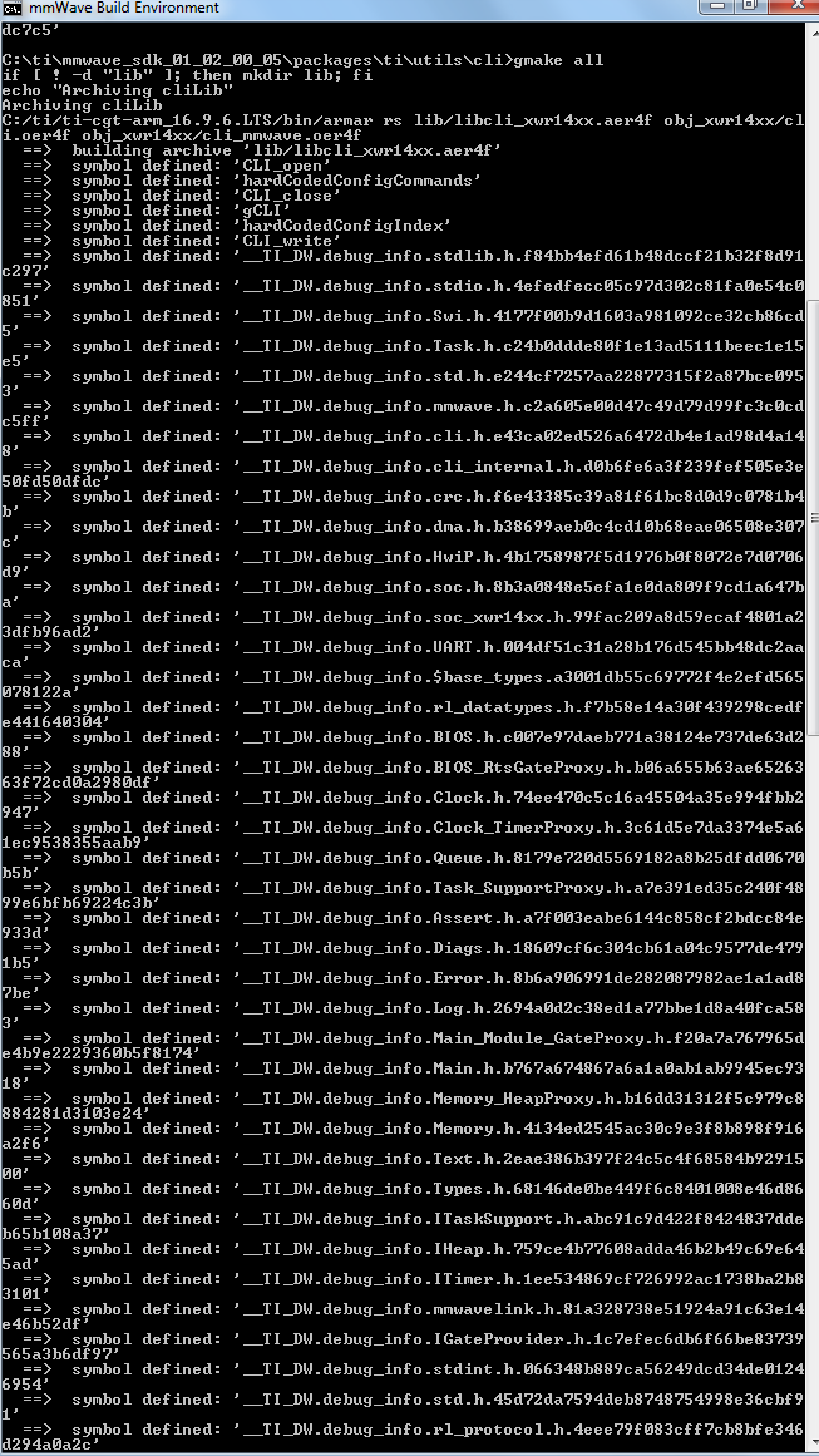

  • Hi, i tried rebuilding the CLI libraries in utils folder. make clean command worked fine, but make all won't work
    now when building my project i get this error:
    error #10008-D: cannot find file "libosal_iwr14xx.aer4f"
    error #10008-D: cannot find file "libesm_iwr14xx.aer4f"
    error #10008-D: cannot find file "libgpio_iwr14xx.aer4f"
    error #10008-D: cannot find file "libsoc_iwr14xx.aer4f"
    error #10008-D: cannot find file "libpinmux_iwr14xx.aer4f"
    error #10008-D: cannot find file "libcrc_iwr14xx.aer4f"
    error #10008-D: cannot find file "libuart_iwr14xx.aer4f"
    error #10008-D: cannot find file "libmailbox_iwr14xx.aer4f"
    error #10008-D: cannot find file "libmmwavelink_iwr14xx.aer4f"
    error #10008-D: cannot find file "libmmwave_iwr14xx.aer4f"
    error #10008-D: cannot find file "libadcbuf_iwr14xx.aer4f"
    error #10008-D: cannot find file "libdma_iwr14xx.aer4f"
    error #10008-D: cannot find file "libedma_iwr14xx.aer4f"
    error #10008-D: cannot find file "libcli_iwr14xx.aer4f"
    error #10008-D: cannot find file "libhwa_iwr14xx.aer4f"
     undefined                        first referenced
      symbol                              in file
     ADCBuf_Params_init               ./main.obj
     ADCBuf_control                   ./main.obj
     ADCBuf_init                      ./main.obj
     ADCBuf_open                      ./main.obj
     CLI_getMMWaveExtensionConfig     ./sensor_mgmt.obj
     CLI_getMMWaveExtensionOpenConfig ./sensor_mgmt.obj
     CLI_open                         ./mmw_high_accu_14xx_cli.obj
     CLI_write                        ./main.obj
     EDMA_getNumInstances             ./data_path.obj
     EDMA_init                        ./data_path.obj
     ESM_init                         ./main.obj
     GPIO_enableInt                   ./sensor_mgmt.obj
     GPIO_init                        ./main.obj
     GPIO_setCallback                 ./sensor_mgmt.obj
     GPIO_setConfig                   ./sensor_mgmt.obj
     GPIO_write                       ./sensor_mgmt.obj
     HWA_configCommon                 ./data_path.obj
     HWA_configParamSet               ./data_path.obj
     HWA_configRam                    ./data_path.obj
     HWA_enable                       ./data_path.obj
     HWA_enableDoneInterrupt          ./data_path.obj
     HWA_init                         ./data_path.obj
     HWA_open                         ./data_path.obj
     HWA_reset                        ./data_path.obj
     HWA_setDMA2ACCManualTrig         ./data_path.obj
     MMWave_config                    ./sensor_mgmt.obj
     MMWave_decodeError               ./sensor_mgmt.obj
     MMWave_execute                   ./main.obj
     MMWave_getChirpCfg               ./main.obj
     MMWave_getChirpHandle            ./main.obj
     MMWave_getNumChirps              ./main.obj
     MMWave_getProfileCfg             ./main.obj
     MMWave_init                      ./main.obj
     MMWave_open                      ./sensor_mgmt.obj
     MMWave_start                     ./main.obj
     MMWave_stop                      ./sensor_mgmt.obj
     MMWave_sync                      ./main.obj
     Mailbox_init                     ./main.obj
     Pinmux_Set_FuncSel               ./main.obj
     Pinmux_Set_OverrideCtrl          ./main.obj
     SOC_init                         ./main.obj
     SOC_registerSysIntListener       ./main.obj
     UART_Params_init                 ./main.obj
     UART_init                        ./main.obj
     UART_open                        ./main.obj
     UART_writePolling                ./main.obj
     _DebugP_assert                   ./data_path.obj
    error #10234-D: unresolved symbols remain
    error #10010: errors encountered during linking; "iwr14xx_high_accuracy_mss.xer4f" not built
    >> Compilation failure
    makefile:167: recipe for target 'iwr14xx_high_accuracy_mss.xer4f' failed
    makefile:163: recipe for target 'main-build' failed
    gmake[2]: *** [iwr14xx_high_accuracy_mss.xer4f] Error 1
    makefile:158: recipe for target 'all' failed
    gmake[1]: *** [main-build] Error 2
    gmake: *** [all] Error 2
    **** Build Finished ****
    how do i fix this? i haven't had these issues before. again, all because i ran make clean.

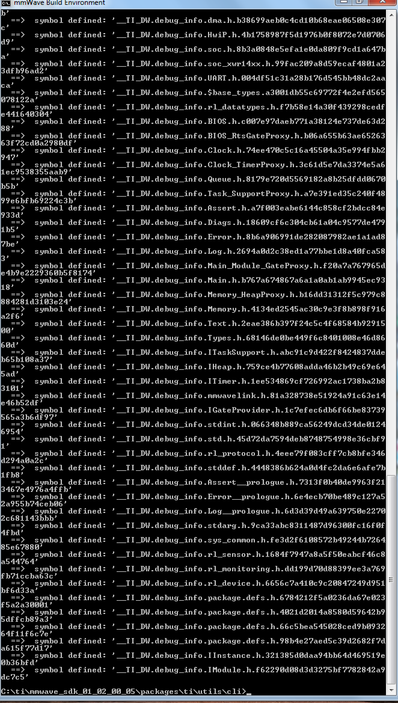

  • This is the output i get when running gmake all:
    how do i proceed?
    cheers

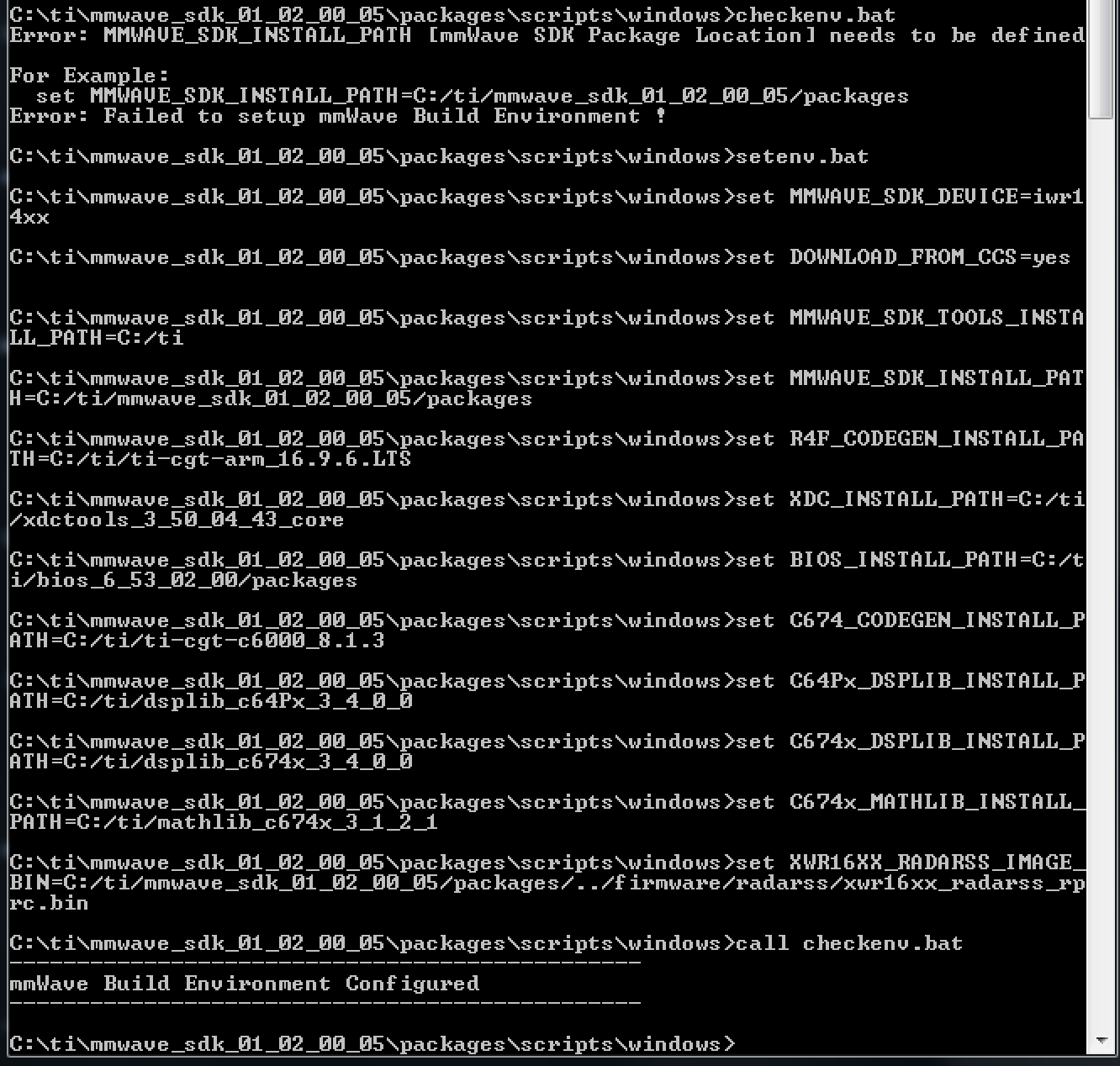

  • Jason,
    Did you setup the compiling environment first?
    Thanks and Regards
    Michelle

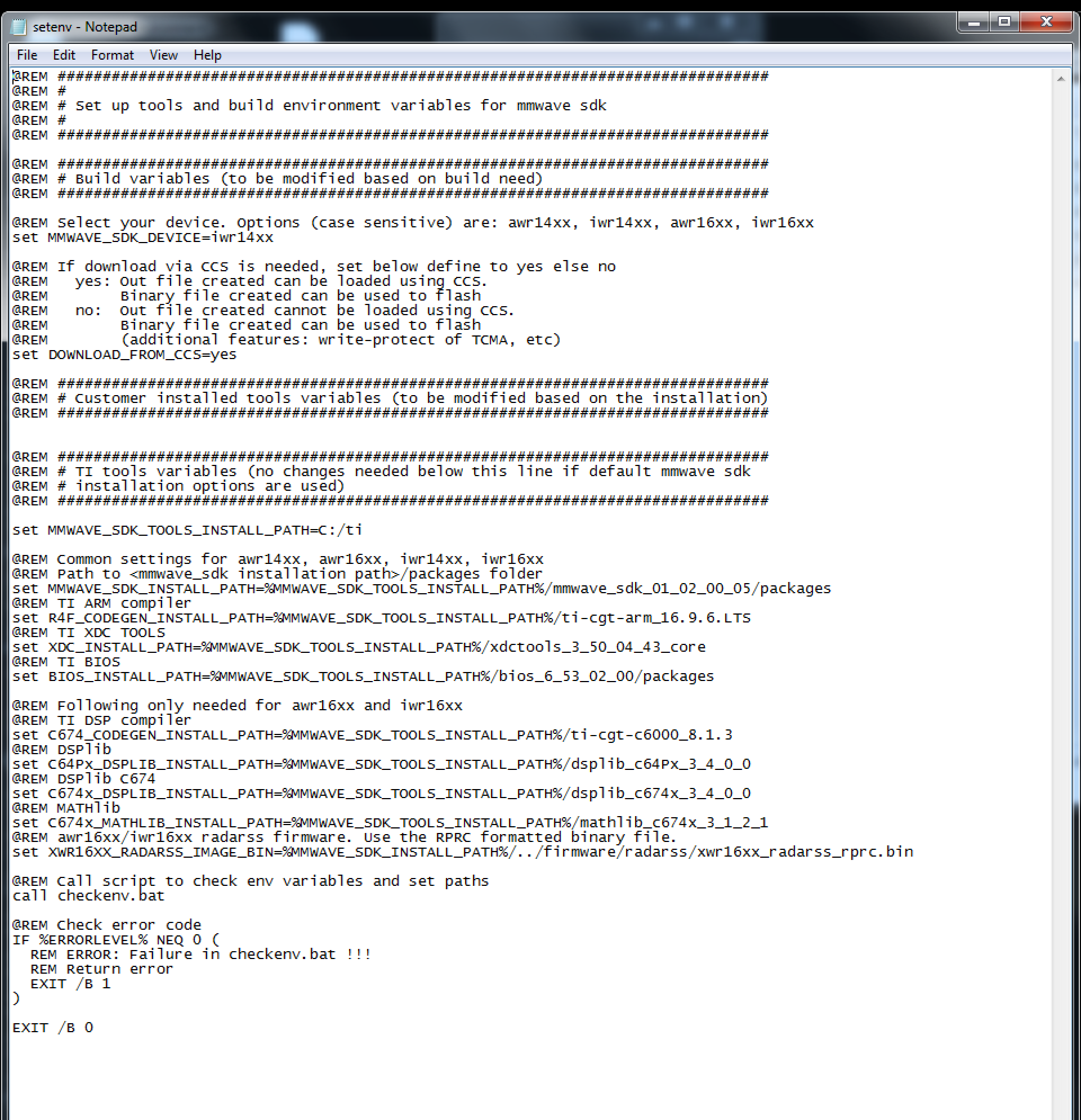

  • Yes i did, see the setenv.bat script output and contents:
    thank you,
    Jason
