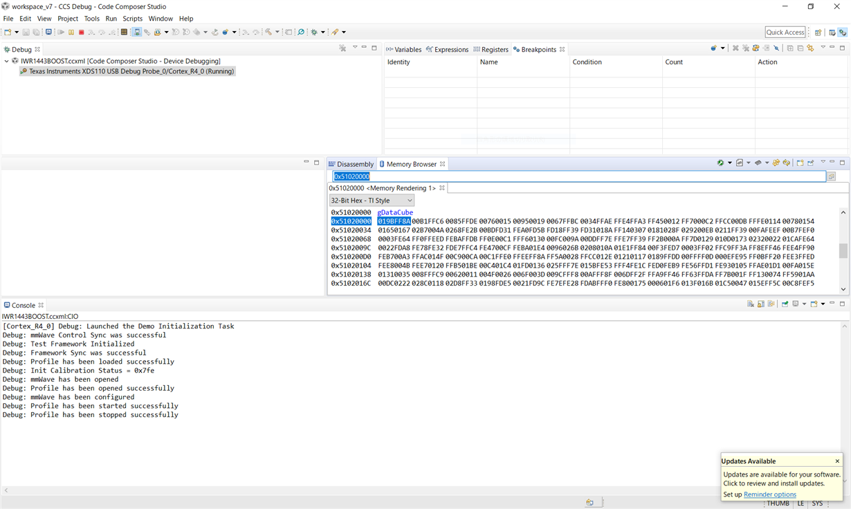

I have tried the CSI stream application demo but the CSI seems to not output data.
 \mmwave_sdk_01_02_00_05\packages\ti\drivers\test\csi_stream\xwr14xx\xwr14xx_csi_stream_mss.xer4f
I used IWR1443BOOST alone and traced the CSI output signals from the 60-pin HD connector. The clock is output, but no data is output (no change).
How can data output from CSI be enabled?
