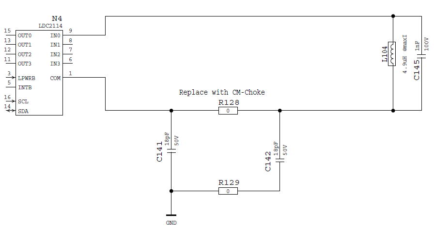

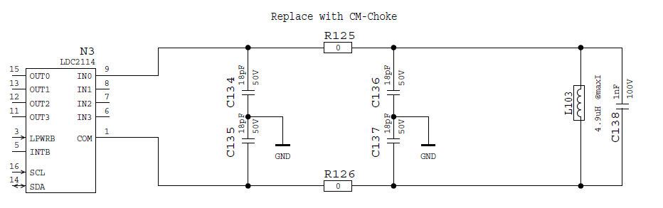

  • Hi Clancy,
    thanks for you answers, they help us a lot.
    I still have trouble understanding how to implement the filters.
    Could you check the following two schematics and describe how to implement the filters?
    • Should the filters placed between IN-Channels and COM?
    • Or should the filters be placed between COM and GND?
    Thank you very much!
