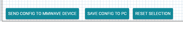

    I was checking the mmwave.js for modification and I have a question regarding the demo itself. When we try to select more plots to show and press "Send config to mmwave device", it shows  "Warning: Heatmap plot is selected. Lower frame rate to be less than 5 fps." or ""Warning: Try reducing the number of plots or reducing the frame rate for better performance". Is it possible to show these messages before we press the button ?, since it is annoying when we send the config and the device sometimes go into locked mode (no response) and we need to reset it again.
    Furthermore, in which .js file,the widget binding associated with these buttons defined?
    Sheeraz
  • Hi Sheeraz,
    Thank you for your feedback regarding the mmWave Demo Visualizer.  I will pass it on to the software team.
    The binding for the buttons you showed is in the index.gui file.  If you search that file for the ID of the button (i.e. ti_widget_button_send_command) you will find a line that uses the onclick property to call a function in mmwave.js when the button is pressed.  For example, here is the line for the Send Config to mmWave Device button.
    <ti-widget-button id="ti_widget_button_send_command" label="Send Config to mmWave Device" button-type="default" raised visible bindable-trigger="34" class="_TI_" onclick="onSendCommand()" elevation="1" animated title></ti-widget-button>
