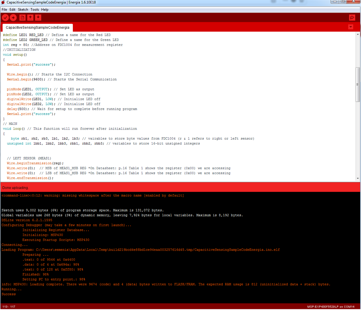

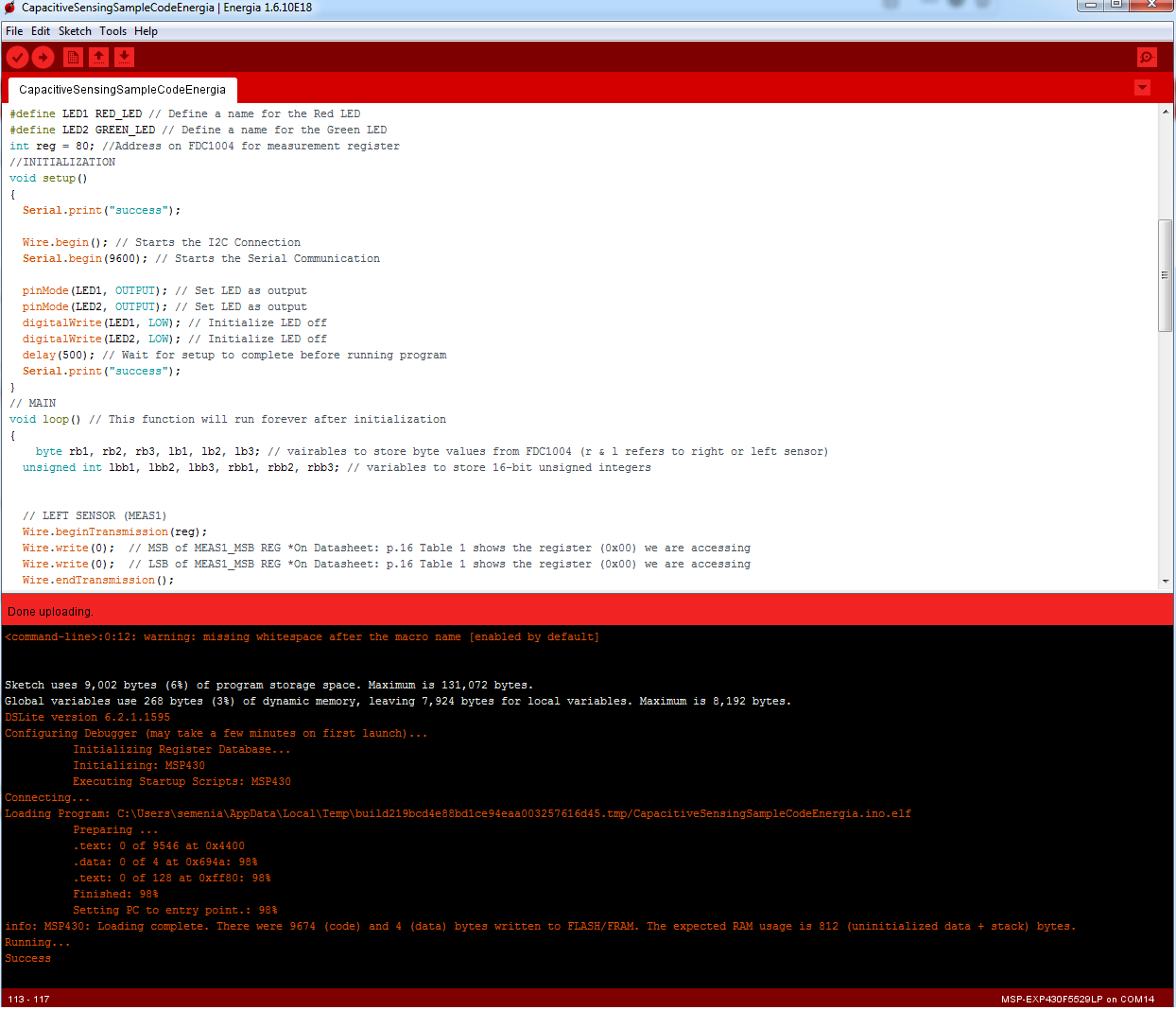

We have some troubles running FDC1004 with MSP430F5529LaunchPad.
I am following Getting Started Guide and use the sample code you've shared earlier,
everything complies fine, uploads fine too, but Serial Monitor is just blank!!!
During Upload green light is on and the red one is blinking on launchpad, indicating
data transfer between eZ-FETlite and IDE.
So it seems like we are uploading to eZ-FETlite emulator and not FDC itself.
Could you please kindly advise how to fix it?)

  • Alex,
    I will help you with this, but I need some time to download the code and try this myself. Our expertise is with the FDC devices, not firmware, so I recommend that you post this question again but tag the MSP430. You might get faster help there.
    -Clancy
  • Hello Clancy,
    I think we have found a way to get it working. We had to put
    Wire.setModule(0);
    line before
    Wire.begin();
