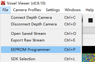

What is the function of EEPROM Programmer? Is it download the firmware of OPT9221?
Hi Li,
Your understanding is correct. EEPROM programmer in voxel viewer is used to program OPT9221 firmware.
Nithin
