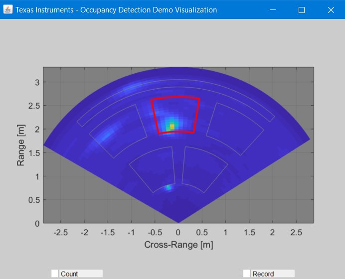

    As I mentioned on the phone, this will require running the "feature" and "decision" algorithms over pairs of zones, since they were designed to run on a pair of zones.  I have made most of the software changes for to create 3 pairs of zones, and have it running in the GUI.  The only thing remaining is to expand the CLI interface to accept 3 sets of coefficients, then do the training required for the new zones.  Currently all 3 zone pairs are running with the same coefficients, so they aren't quite as reliable yet as the first two zones.
    I should be able to get this to you in a few days. You will need to do your own training, because I probably won't be able to get to that for a while.  The 6 zones I have defined look like this:
    The corresponding zone definition is this:
    zoneDef 6 16 16 8 15 16 16 26 15 37 15 6 11 37 15 31 11 37 15 19 10 55 4 6 36
    In the meantime, if you wanted to try doing training, follow the procedure listed in the user guide using the following two sets of zones.  Of course, you may want adjust the zone placement first, this is a generic configuration.  Unless you change the first two zones, you shouldn't have to re-train them, though it is not a bad idea when running in a new environment (ie. a different car).
    zoneDef 2 37 15 6 11 37 15 31 11 (2nd zone pair - 1st and 3rd zones on the second row)
    zoneDef 2 37 15 19 10 55 4 6 36  (3rd zone pair - middle zone on second row and third row zone)
      -dave

    You shouldn't need to open these files, other than with the tools. When you run the gui to collect the data, you should use one of the two pairs of zone definitions from above: (or your updated zone defs)
    The Matlab gui will then show you the heatmap and these zone definitions, so you can center a person in each occupied zone prior to starting recording. Or are you trying to do something else with the files? Each "row" should be a 48x64 cell heatmap.

  • Ah, I see. It is much easier to simply run the demo and have a person sit in a zone. Then adjust the zone definition and restart the demo until you're satisfied with it. Try to leave a few low-power cells surrounding the bright spot inside the zone, or at least a few cells in between zones, so that the bright spot doesn't inadvertently trigger a neighboring cell.
