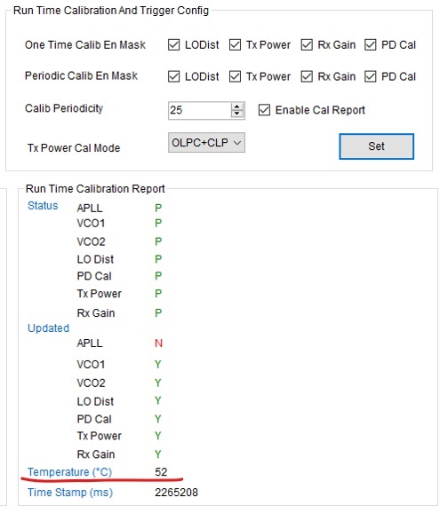

AWR1642BOOST: What's the calibration temperature in mmWave Studio and Where did it measured?
Part Number: AWR1642BOOST
Dear support team
I found that there is a calibration temperature in the mmWave Studio.
Could you tell me What does the calibration temperature mean and Where did it measured?
Roger
  • Hi Roger,
    The temperature in the report is the measured device temperature at the time of calibration. This is the average of the temperature readings from the temperature sensors located near the TX and RX channels in the device.
    For more information on calibration-related topics, I would recommend our application note on the topic: www.ti.com/lit/an/spracf4/spracf4.pdf
