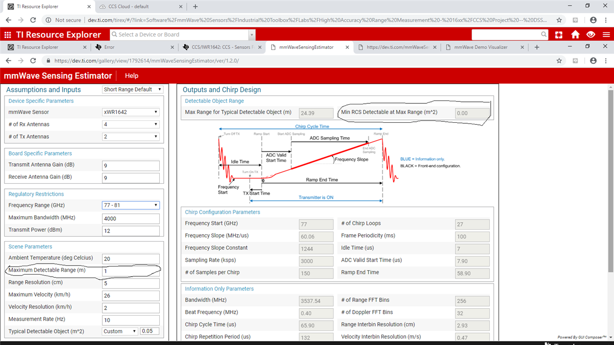

  • Hi Karthik,
    You can look at the mmWave Sensing Estimator (dev.ti.com/mmWaveSensingEstimator) to calculate the minimum detectable RCS for a specified chirp configuration. However, although a face may have a large RCS which will allow detection of the face as a whole, differentiating specific points on the face may be difficult due to the angular resolution of the antenna.
    The mmWave SDK demo produces a list of detected points each with an X,Y,Z position. Please look at the mentioned SDK demo documentation for details of the processing chain and data output.
    John
    As shown in above fig I have set distance of det as 1m, and typical detectable object custom of 5cm*5cm for face, But the min RCS at max det distance is not showing any value?

  • Hi Karthik,
    The mmWave Sensing Estimator is calculating a min RCS but since the antenna and power level are designed for much longer distances, setting the max range to 1m will cause the min RCS at that distance to be extremely small (less than 0.01) and the estimator will just show 0.00. If you change the pull-down option near the top to Long Range Default you will see a non-zero min RCS.
    We have not tried to detect portions of a face. You would need to experiment.

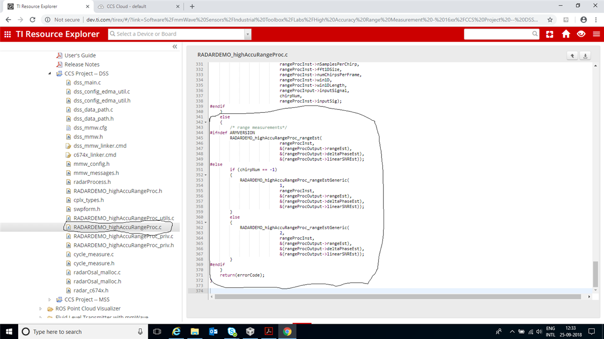

    I IWR1443 I could get range value, segment as shown , in same way where do I get this segment in any of IWR1642 DEMO
  • Hi Karthik,
    There is no single range value produced by the mmWave SDK out-of-box demo. It produces a list of detected points with an X,Y,Z position for each point. You would need to add your own code to process these points as desired.
    As described in the mmWave SDK demo documentation mentioned in my earlier post, the DSP sends all of the data to the ARM to be sent out over UART. You can search the ARM file "C:\ti\mmwave_sdk_02_00_00_04\packages\ti\demo\xwr16xx\mmw\mss\mss_main.c" for "MMWDEMO_DSS2MSS_DETOBJ_READY" to find the place that the ARM receives the data and sends it over UART. The data format/structure is also described in the mmWave SDK demo documentation. (C:/ti/mmwave_sdk_02_00_00_04/packages/ti/demo/xwr16xx/mmw/docs/doxygen/html/index.html)
    John
    Could you pls explain how this was done in water level indicator example, where they displayed in water level in GuI but source code is not available. If I could get that example It would be very greatful
  • Hi Karthik,
    The fluid level measurement example is just a different GUI for the IWR1443 High Accuracy lab.  There is also a IWR1642 High Accuracy lab.  Both labs will return the distance to the single strongest point measured.
    John

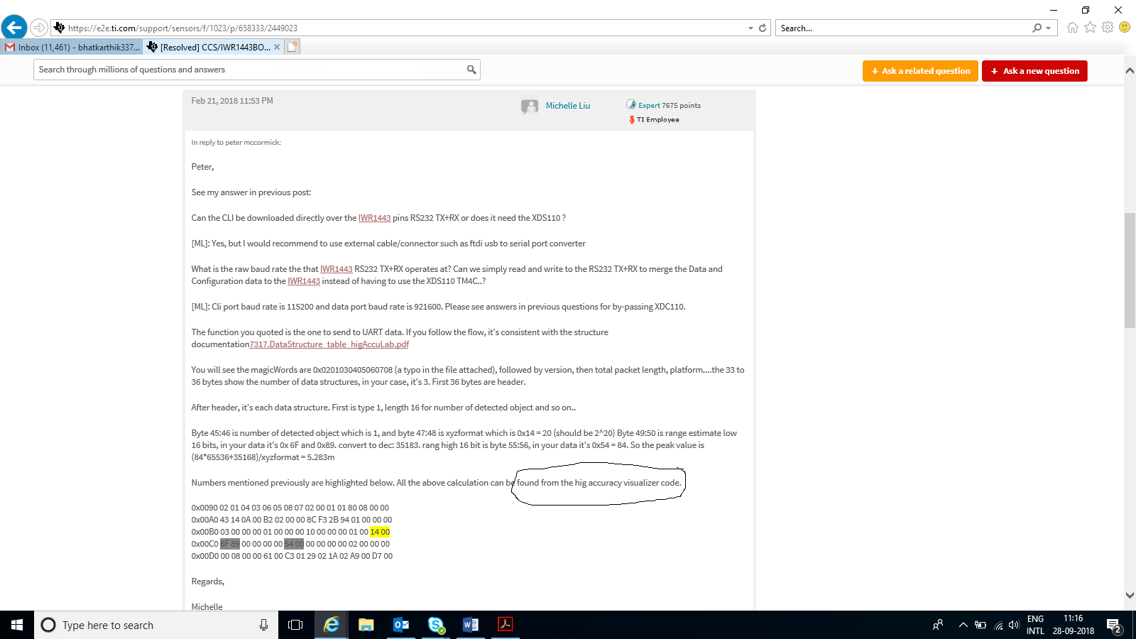

  • Hi Karthik,
    If you are referring to the High Accuracy lab then its output data format is described in the following thread.
    e2e.ti.com/.../2449023
    If you are talking about the mmWave SDK out-of-box demo then it outputs X,Y,Z for each detected point. Please see the demo documentation for more details. The processing I mentioned just referred to any processing you want to do with the list of detected points.
    John

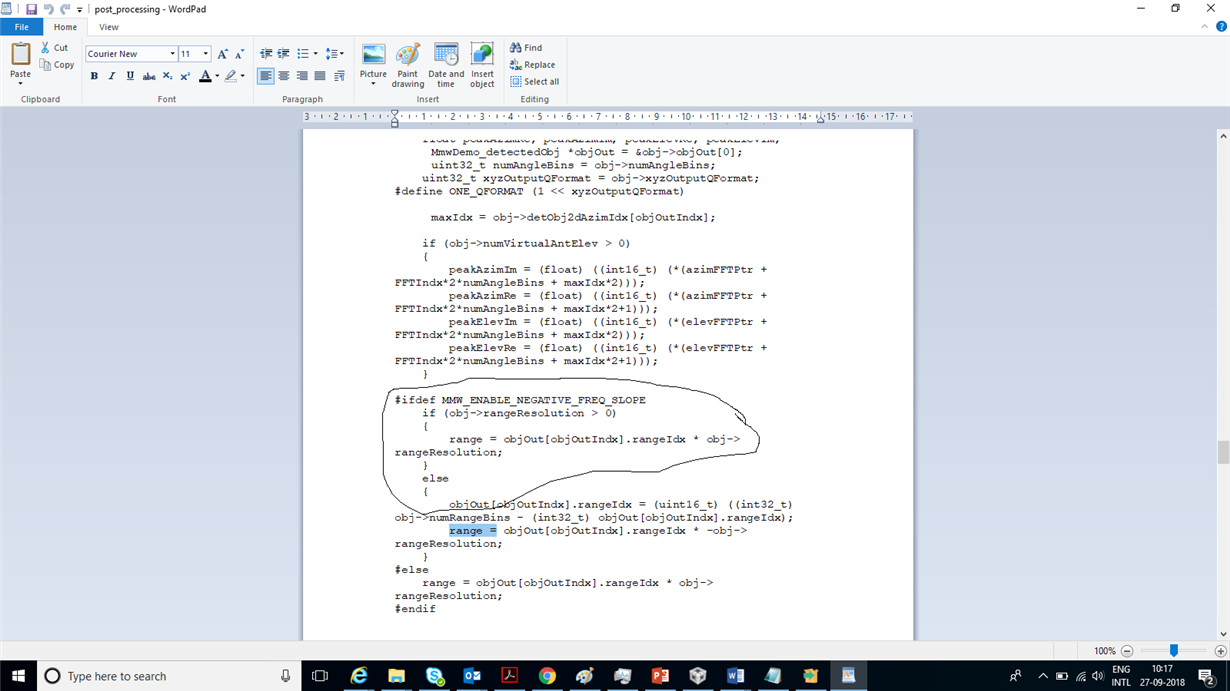

    I just went through the post you mentioned, there its reffering to demo visualizer processing. In our case we want to process in CCS and based on condition GPIO pin should be made high.
    pls attach the link of any post related to this. So that it would be helpful.

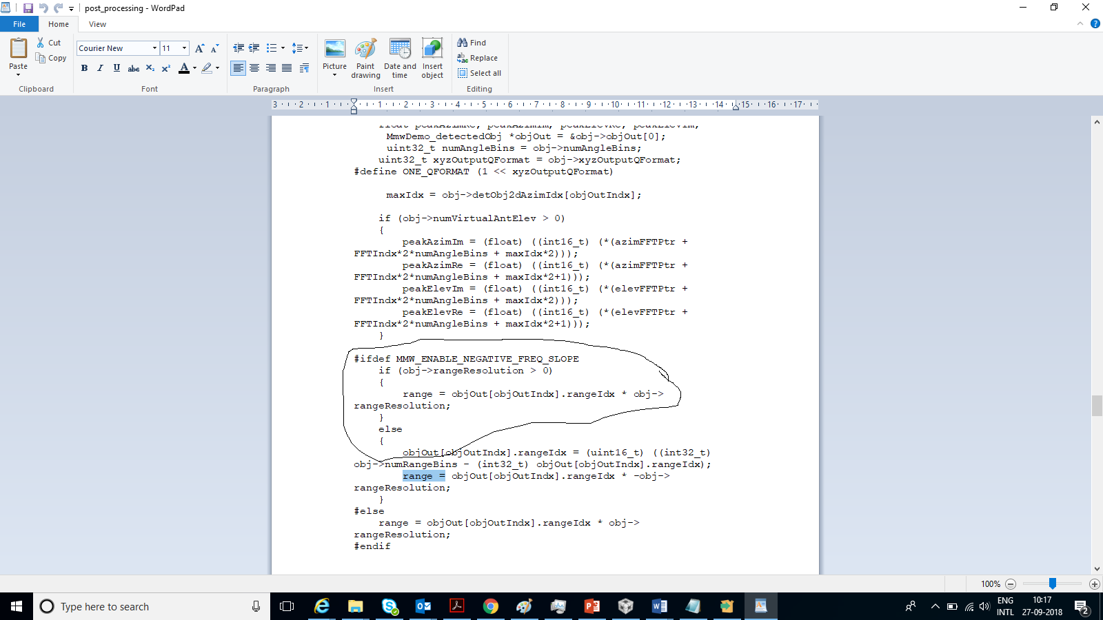

    Could u pls elaborate what does x,y and z position means and how can I utilize to get my range.
    The range calculation what they do in visualizer can it be tried to be done in ccs in DSP itself?
  • I will use demo visualizer only during my setup, rest I will be using only MMwave IC with one GPIO signal from it.
    If I could do the same kind of processing before data going to visualizer, it would be very helpful for me.
    Pls help me in this , or atlest route to any body who can support me on this with some detail.
    regrads
    Karthik s

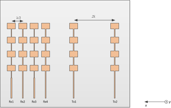

  • Hi Karthik,
    Regarding your question about X,Y,Z:
    The coordinate system used by the mmWave SDK demo is described in the demo documentation and copied here.
    Antenna Configurations
    The following figure shows antenna layout as seen from the front of the EVM xWR16xx board alongside the x,y coordinate convention.
    AWR16xx Antenna layout
    As shown in the figure, from the point-of-view of the antenna on the IWR1642 the X value is how far the object is to the side and the Y value is how far the object is in front of the antenna.  If the object was directly in front of the antenna then the Y value would be equal to the range of the object.  Since the IWR1642BOOST EVM does not have an elevation antenna Z is always reported as 0.
    John

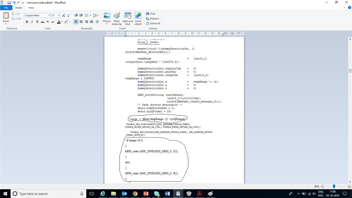

  • Karthik,
    As I mentioned, if you are interested in finding the distance to the strongest point only, then you can use the High Accuracy demo.  The range value in the ARM/MSS code can be found in mss_main.c in the following section.
    tlvIdx = 0;
    /* Send detected Objects */
    MmwDemo_output_message_dataObjDescr descr;
    MmwDemo_detectedObj dummyDetectionOut; //work around the current format
    int32_t tempRange;
    memset((void *)&dummyDetectionOut, 0, sizeof(MmwDemo_detectedObj));
    tempRange = (int32_t)(outputData->rangeEst * 1048576.f);
    dummyDetectionOut.dopplerIdx = 0;
    dummyDetectionOut.peakVal = 0;
    dummyDetectionOut.rangeIdx = (uint16_t) tempRange & 0xFFFF;
    dummyDetectionOut.x = tempRange >> 16;
    dummyDetectionOut.y = 0;
    dummyDetectionOut.z = 0;
    UART_writePolling (uartHandle,
    (uint8_t*)&tl[tlvIdx],
    sizeof(MmwDemo_output_message_tl));
    /* Send objects descriptor */
    descr.numDetetedObj = 1;
    descr.xyzQFormat = 20;
    UART_writePolling (uartHandle, (uint8_t*)&descr, sizeof(MmwDemo_output_message_dataObjDescr));
    /*Send array of objects */
    UART_writePolling (uartHandle, (uint8_t*)&dummyDetectionOut, sizeof(MmwDemo_detectedObj) * 1);
    tlvIdx++;
    In this code the range would be (float) tempRange / (2 ^ xyzQFormat) = (float) tempRange / (2 ^ 20).
    John
  • Hi, This calculated value Temprange will be in meters unit.
    alos could u pls explain in the same segment can I compare this range and enable  GPIO pin 2.
    In doxygen GPIO is mentioned as function.
    Can it be enabled without using the function. Since I want to enable inside the same function you shown.
    if not in this function where can i do this process?

  • Hi Karthik,
    You can look at the mmWave SDK demo code to see how to use the GPIO functions. Look at C:\ti\mmwave_sdk_02_00_00_04\packages\ti\demo\xwr16xx\mmw\mss\mss_main.c. You will see the GPIO_2 pin being setup initially in the following initialization code.
    * Setup the PINMUX:
    * - GPIO Output: Configure pin K13 as GPIO_2 output
    Pinmux_Set_OverrideCtrl(SOC_XWR16XX_PINK13_PADAZ, PINMUX_OUTEN_RETAIN_HW_CTRL, PINMUX_INPEN_RETAIN_HW_CTRL);
    Pinmux_Set_FuncSel(SOC_XWR16XX_PINK13_PADAZ, SOC_XWR16XX_PINK13_PADAZ_GPIO_2);
    * Setup the DS3 LED on the EVM connected to GPIO_2
    GPIO_setConfig (SOC_XWR16XX_GPIO_2, GPIO_CFG_OUTPUT);
    Then you will see its output value being set in the following lines.
    /* Turn on the LED */
    GPIO_write (SOC_XWR16XX_GPIO_2, 1U);
    /* Turn off the LED */
    GPIO_write (SOC_XWR16XX_GPIO_2, 0U);
    John

  • Karthik,
    Here is some info regarding your question about the mmWave SDK demo. However, it will require a good knowledge of C programming to understand and use it and you would need to look through the code yourself in detail if you still have questions about it. If it is too complicated then please stick with the High Accuracy demo code which is easier to extract the range from.
    In the mmWave SDK demo, if you are just inside the "Send TLVs" loop in mss_main.c:
    /* Send TLVs */
    for (itemIdx = 0; itemIdx < message.body.detObj.header.numTLVs; itemIdx++)
    <HERE>
    Then the message.body.detObj.tlv[itemIdx] is the variable that holds the structure for each data type (TLV) described in the demo documentation. When (message.body.detObj.tlv[itemIdx].type == 1) then the address returned by the following expression will point to the structure that includes the detected points:
    "(uint8_t*)SOC_translateAddress(message.body.detObj.tlv[itemIdx].address,
    SOC_TranslateAddr_Dir_FROM_OTHER_CPU,NULL)"
    The structure that the address points to is described in the demo documentation as follows.
    "List of detected objects
    Type: (MMWDEMO_OUTPUT_MSG_DETECTED_POINTS)
    Length: (size of MmwDemo_output_message_dataObjDescr_t) + (Number of detected objects) x (size of MmwDemo_detectedObj_t)
    Value: List descriptor (MmwDemo_output_message_dataObjDescr_t) followed by array of detected objects. The information of each detected object is stored in structure MmwDemo_detectedObj_t. When the number of detected objects is zero, this TLV item is not sent."
    The definition of the MmwDemo_output_message_dataObjDescr_t is found in C:\ti\mmwave_sdk_02_00_00_04\packages\ti\demo\io_interface\mmw_output.h:

    int16_t x; /*!< @brief x - coordinate in meters. Q format depends on the range resolution */
    int16_t y; /*!< @brief y - coordinate in meters. Q format depends on the range resolution */
    int16_t z; /*!< @brief z - coordinate in meters. Q format depends on the range resolution */
    } MmwDemo_detectedObj;
    x/y/z are in Q format (en.wikipedia.org/.../Q_(number_format). For example, to get Y in meters you would calculate:
    Y_in_meters = (float) y / (2^xyzQFormat)

  • Hi John,
    Can I put the expression of range=float(range)/(2^20), inside the same object where it is calculated?
    Also in which part of high accuracy code I can do the comparison and make gpio PIN HIGH?
  • Hi, As you told  I have made changes in high accuracy lab.
    I will use GPIO 0, since it is in J6 tag of the IWR1642 demo.
    when range is less than 0.1 m, GPIO will be high , when its not GPIO will be low.
    Pls see the code I have modified, check once
  • I have already got IWR 1642 BOOST EVM, but in release notes of High accuracy demo, it is telling that it is compatible with ES2... what exactly is this? I don't have ES2 marked on my board and I want to try High accu demo. Can I directly download the code and see?
    What is the difference between tempRange and range formula you have explained? which value is displayed in high accuracy demo?

    In high accuracy lab , I am not able to get the accurate range. If the actual range is 10cm, visualizer showing 16 cm. How do I get accurate value what I am suppose to do?
    I did not get the ans for the place where I have to calculate range and enable GPIO. Is it fine where I have put in my last post image.?
    Please help me in putting it at right place so that, calculated value would be compared with threshold and any GPIO pin which is avilable on board needs to made high if it is less.
  • Karthik,
    Please do not ask the same question in multiple threads. Your question about the 6cm offset is addressed in your other thread (e2e.ti.com/.../733734).
    As far as I can tell from looking at your code it should work. However, you would need to compile and test/debug it to make sure.
    John
  • You mean the attched image stating enabling GpIO based on condition right?
  • Yes, I was referring to the image you attached with the modified code.
    John

    I am able to do this change of range calclate expression and edit by putting gpio 2 expression.
    buiding with no error, with dss having error, i tried to flash .bin which was genersted in mss folder in workspace.
    loaded succesfully, but when i tried to load conifg file in demo visualizer, from toolbox 1.6.2. it is not able to show any version, scene details.
    help me to get this done.
    I am able to Modify the code, witout any errorrs. But The place where I put that range calculation, it is not able to able to calculate.
    as shown in last imagew the code was written inside of dataptransmsissout()
     since I have temprange and wxzq, but this is not working. Pls help me on this.I have already explained you the application.
    If you coukld exolain with code it would be good.
    Please help me to get this done.
