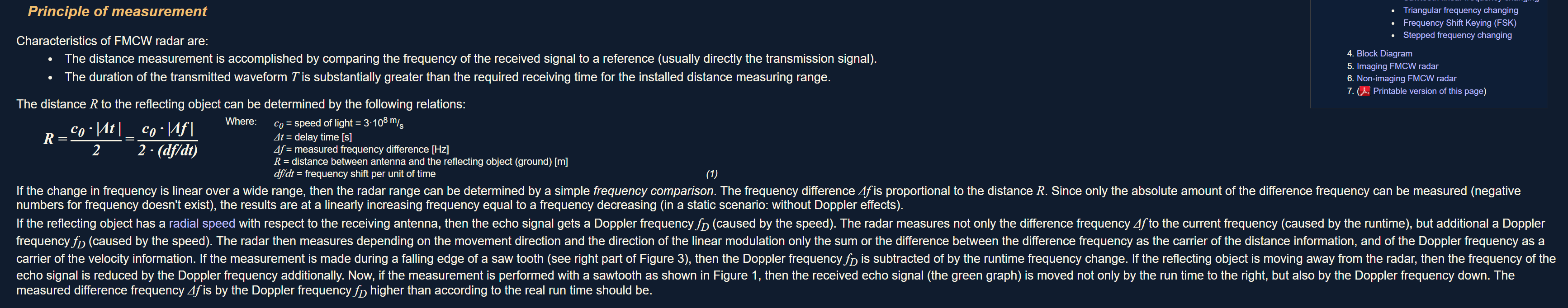

  • The FMCW radar equations shown in " radartutorial.eu/02.basics/Frequency%20Modulated%20Continuous%20Wave%20Radar.en.html"
    Provide for the beat frequency to range conversion.  The DFEoutputrate / numFFT points provides the frequency / FFT bin,
