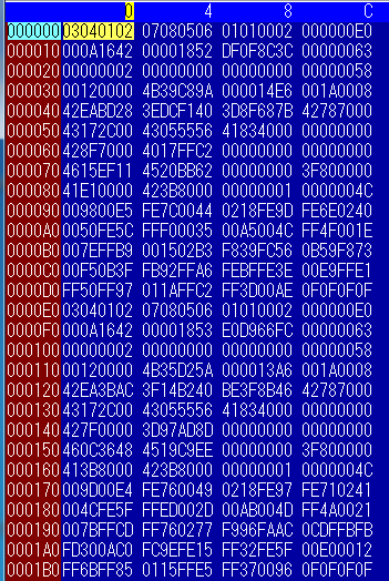

I am using Vital Signs lab (mmwave_automotive_toolbox_1_2_0) on AWR1642. It is working fine. I would like to extract heart waveform and motion detection from dataOutputFromEVM.bin. From source code (host and target), it appears
Message header : 40Bytes
TLV Message header : 8Bytes
Output status : 88Bytes
Heart waveform is 7th (i.e. INDEX_HEART_WAVEFORM) and motion detection is 20th (i.e. INDEX_RESERVED_1) in output status, respectively. Is my understanding correct?
Here is my screen shot of dataOutputFromEVM.bin.
If my understanding is correct,
First heart waveform data is 0x3D8F687B (0.070023) at 0x48 (Message header + TLV Message header + (7 - 1)*4)
First motion detection is 0x3F800000 (1) at 0x7C (Message header + TLV Message header + (20 - 1)*4)
Could you please review?
