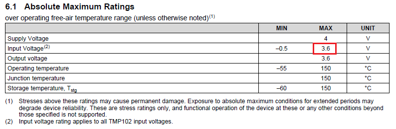

Is it possible to apply 3.3V to SCL, SDA, ADD0 and ALERT when powering off (V+=0V)?
I would like to know if TMP102 could be damaged or not in this case.
I believe it is possible according to the following absolute maximum ratings however would like to confirm just in case.
