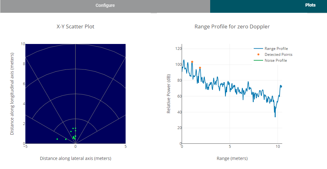

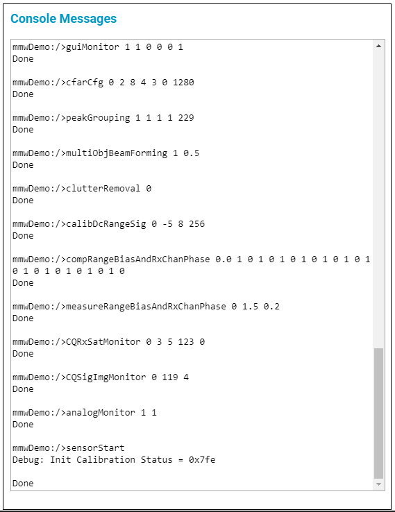

We are able to communicate with the device over USB via the Visualizer app. If we manually configure the system to "2Rx,1Tx(60deg)" mode, the configuration is successful, the "sensorStart" command receives a "Done" appropriately, and we can move to the Plot tab and see data.

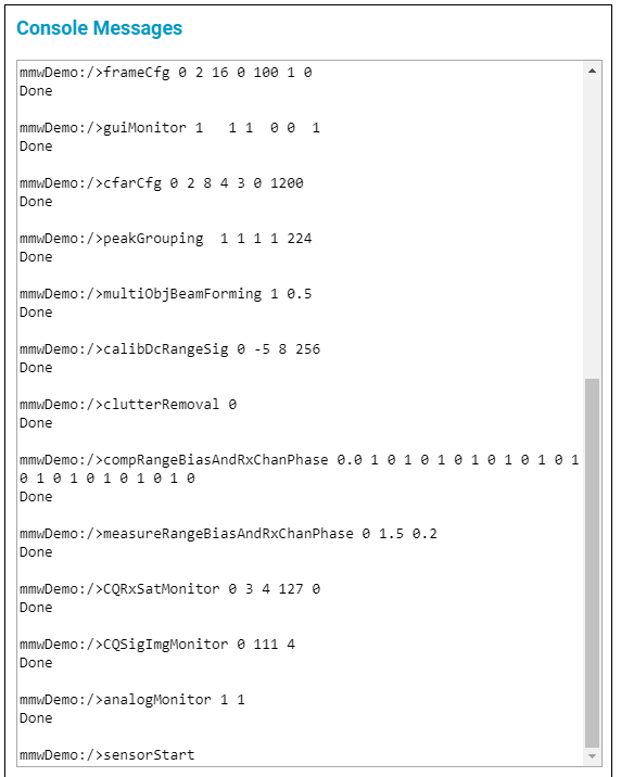

If we try to use any of the 2d or 3d profiles, or configure manually with "4Rx,3Tx(15 deg + Elevation)" mode, the configuration appears to be successful ("Done" is received for all commands issued to the AWR1443BOOST), but the "sensorStart" command hangs, no "Done" is received, and there is no data available on the Plot tab.  See the screenshots below of the configuration commands / responses, and the plot tab results.
However, when we try to either use the default "4Rx,3Tx(15 deg + Elevation)" mode from the Demo Visualizer drop-down, or load the file "profile_3d.cfg from the SDK v1.2 at this location:
C:\ti\mmwave_sdk_01_02_00_05\packages\ti\demo\xwr14xx\mmw\profiles\profile_3d.cfg
Then the configuration appears to be successful ("Done" is received for all commands issued to the AWR1443BOOST), but the "sensorStart" command hangs, no "Done" is received, and there is no data available on the Plot tab.  The system hangs after sending the sensorStart command (there is no response of "Done") and the device is non-responsive on either UART.  See the screenshot below.
This result also occurs with any of the other .cfg files in this folder, as well as manually programming to any of the 4Rx modes in the Visualizer.

  • We tested with a second, separate 5V/2.5A power adapter and the board appears to be functioning properly now in 3Tx/4Rx mode (3D).  We are able to complete the configuration using the 3D profile config file and see data on the Plot tab.
    Please note that we did not receive a power adapter in the kit from TI, so we used one from a different device that was under spec described in user guide.
    We also powered the device off of a digital bench power supply and at 5V it is only drawing ~310-330 mA so it's not clear why the old/bad 5V/2.5A power adapter was not working with the AWR1443BOOST.  This adapter functions fine when powering another device drawing >3x that amount of current so it's not a current limit issue.
    If TI would have any insight into this matter from a HW perspective, it would be appreciated, but at this time my issue appears to be resolved.  Thanks for your time and attention.
