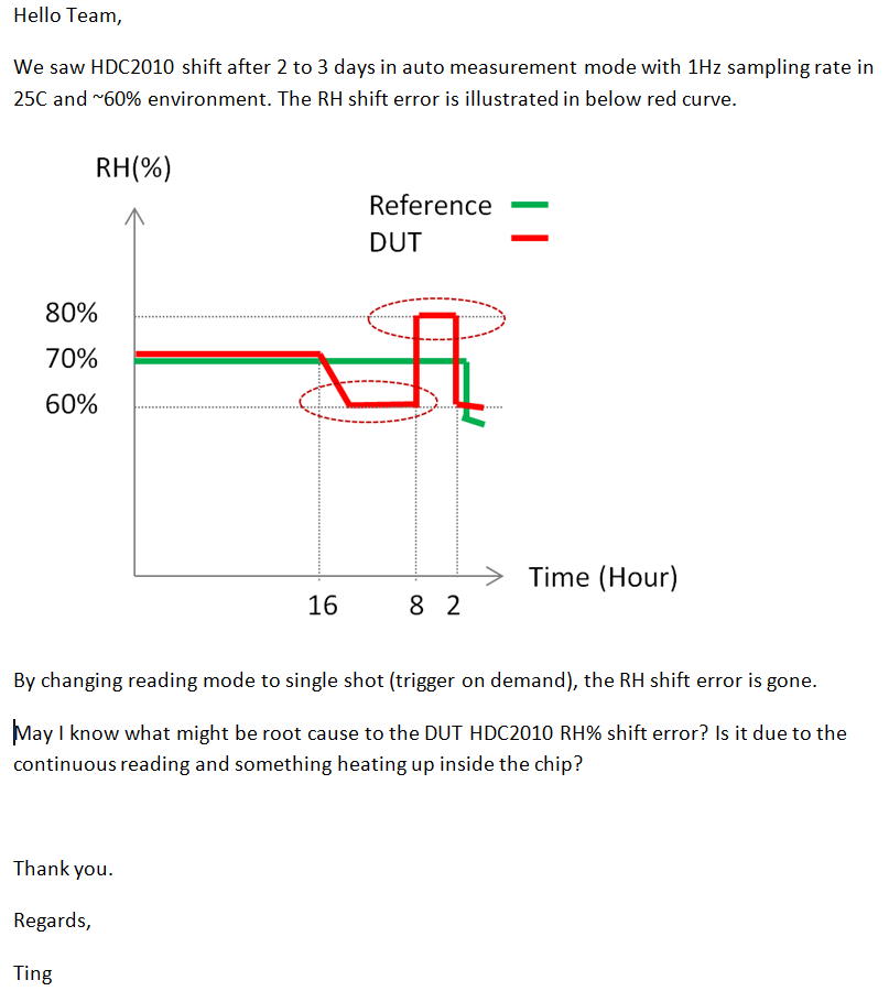

Part Number: HDC2010
Hi Ting,
Yes, you are correct, there is a possibility of self-heating caused by the auto mode feature. One experiment to try is to increase the period of the sampling mode and verify that it improves results.
Matt
