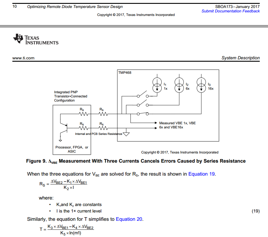

When i reading TI'guide SBOA173-Optimizing Remote Diode Temperature Sensor Design,about TMP468 series resistance cancellation shown as below,I have questions:
1. what △VBE1 and △VBE2 stand for?
2. what the value of K1, K2, K3 , K4 and K5?
3.what the value of m? 6 or 16
