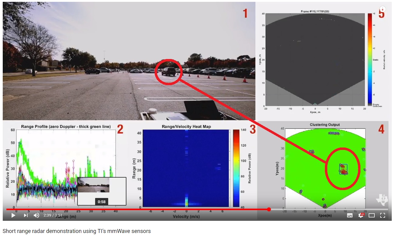

B. In video (2:39) :  Short range radar demonstration using TI’s mmWave sensors (https://www.youtube.com/watch?v=ziQjbVXcSts),
B.1 Why do those points distribute like this? And is it reasonable?
B.2 There is a rectangle used for describing this cluster. Is it suitable for describing target physical size(car)?

    Actually, I'm trying SRR/USRR for BSD(Blind Spot Detection) under any kind of scenario. Also I'm trying taking the advantage of points cloud of USRR to describe target physical size. So far, I have met some issues for this application.
    1. The maximum velocity of USRR is quite low. Do you have any suggestion for improving USRR Maximum velocity and this improvement could keep performance?
    2. I'm not sure what reasonable distribution of points cloud of USRR should be. I found the video(at 2:39) as previous post that shows points cloud distributed almost two parts(front and rear) in the rectangle cluster. So I think this "rectangle" could be used for describing target physical size. But this "rectangle" cluster cases me to ask what reasonable distribution of points cloud of USRR should be. Moreover, why do those points distribute like this as shown in video(at 2:39)?

    While I cannot comment on that particular video, in general, my belief is that it is due to the detection algorithms that we use (CFAR-CA). These algorithms  detect the start point and the end point of a distributed target (i.e a large target like a car), but do not detect points in-between. Other algorithms like CFAR-OS may be better at detected more points on a distributed target.
