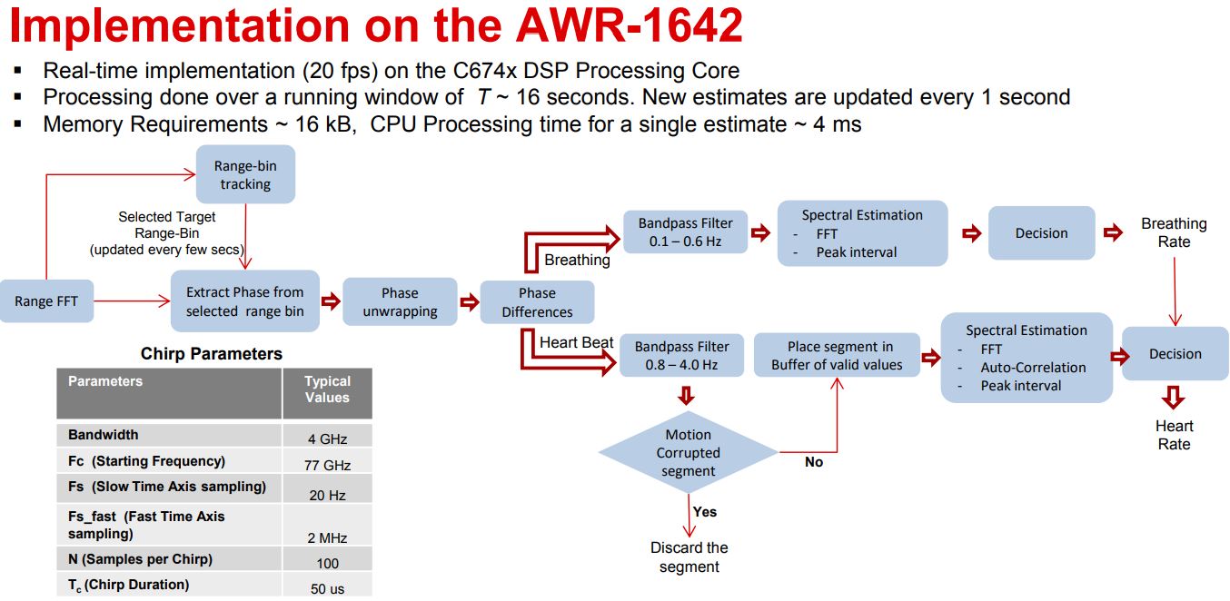

We need to know what variables are the inputs and outputs of all of the small blocks in the following SW functional block diagram.
We need TI’s document that illustrates these variables?
Cause we need to modify the code for our product.
  • Driver Vital Signs
  • Will,
    All of the documentation related to this lab is included on TI's Resource Explorer at dev.ti.com/tirex. TI has provided all of the source code for both the GUI and the target device. This flow chart illustrates what happens during the interframe processing. You can find this function is the dss_data_path.c source file.
