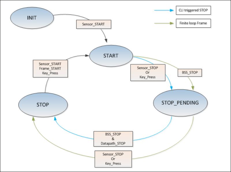

You have partially addressed my question.  Yes, trying to put in a delay while the part is chirping but I tried to issue a sensor stop command to stop the part from chirping before I attempt a delay.  Please correct me if I am wrong but through the command line, if I issue a sensorStop command, the part stops chirping.  This command calls the function  MmwDemo_CLISensorStop. This function calls to other functions, i.e., MmwDemo_notifySensorStop and MmwDemo_waitSensorStopComplete.  When I step through these commands with a debugger, I can step through the MmwDemo_notifySensorStop function but not the MmwDemo_waitSensorStopComplete function since it is waiting for an event to finish.  My question is how can I push the event to happen so I can stop the part from chirping?

    In the meantime, I wonder if you've looked at the demo doxygen, file:///C:/ti/mmwave_sdk_01_02_00_05/packages/ti/demo/xwr14xx/mmw/docs/doxygen/html/index.html
    There is a stop pending step in the diagram attached here:
    Michelle

    Yes I am aware of  this diagram.  I am inserting my code in the function MmwDemo_dataPathTask.  A brief layout of  this function is

    I am adding my code in the clutter removal section.  I have to assume that for the event of stopping the chirping has to wait for the appropriate time.

    l,
    As seen in this diagram:
