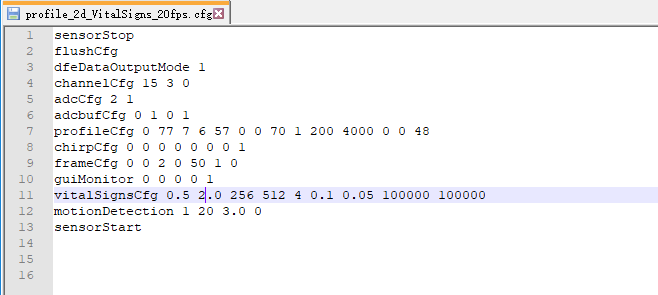

When running the vital sign lab with the IWR1443, the resulting breath and heartbeat data is not accurate. In the absence of anyone, there will still be breathing and heartbeat. I modified the cfg file under the gui folder, but the command line interface that appears when I run the gui shows that the parameters have not changed. I would like to ask how to configure the corresponding parameters in this case? How should the threshold for breathing and heartbeat be set?
  • Guiyuan,
    You need to make sure that you save the changes to the .cfg file before attempting to load them through the GUI. It does not look like you saved the changes and they would therefore not be reflected when you run the GUI.
    For more information about the parameters for the CLI commands, please refer to the Developer's Guide.
