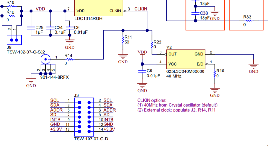

  • Hi Bala,
    I think I figured how to replace the reference clock on the EVM, if you can verify that would be great! Looking at the schematics, R22 has to removed and placed on R14 and R11 has to be populated. LDC1612 datasheet has reference clock listed between 2MHz and 40MHz, for our case, does it make sense to go with 4MHz? Still waiting for answers to my other questions. Thanks.
    Ali
  • Hi Ali,
    I will verify tomorrow if that's the right way to replace the reference clock. About the reference clock, you can pick any frequency within the range, but note that higher the frequency more resolution you can get on your results. For your case the minimum requirement is 4 x fsensor = 400kHz. Since the minimum fref is 2MHz, you need to at least go with this clock frequency. But, you can always go higher for more resolution. I've also replied to you on private message, if you've any other unanswered questions, please let me know.

  • Hi Bala,
    Thanks for your answers.
    Also, this question I had "Reading through the EVM Guide, section 2.7.2 (page 25), it states "The EVM includes a 40-MHz oscillator on-board but an external off-board signal can be used.", so how can we use the external off-board signal?", can we use a function generator instead of the reference clock (in your previous message)? Thanks.
    Ali
  • Hi Ali,
               Sorry about the delayed response. Yes, you can use a function generator instead of the reference clock. As you can see from figure below, you can apply the clock to R14 and you need R11 of 50 ohms and you need to short R22. I hope this helps!

  • Hi Bala,
    Ok, tried it with the function generator and made those changes to the board... however the input "deglitch filter incorrect" is lid red again. I have tried different reference frequencies between 2MHz-20MHz on the function generator and the result is the same. Just to make sure, "External Oscillator" under "Reference Clock Source"on the UI has to match the reference clock I choose, correct? The reason I ask is cuz when I try let's say 10MHz on the function generator and then choose 4MHz as reference clock source on UI, that deglitch filter incorrect indicator on the UI is turned off. Also, I noted on the schematics it says to populate R14 instead of R22 (R14 or R22), that means R22 is to be open... but you had indicated in your last post to short R22, can you please verify on this? Thanks.
    Ali
  • Hi Ali,
    Can you please share a picture of the "Deglitch filter incorrect" is lit red? Yes, your external oscillator should match the ref clock on your GUI. Sorry about the confusion earlier, R22 must be open when using an external clock.
    Bala Ravi
