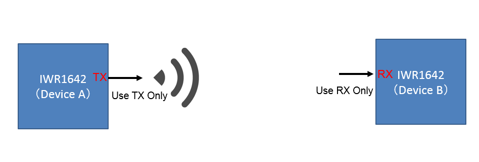

Is it possible to set transmission or reception only for IWR1642/IWR1443?
I would like to receive the TX chirp output from IWR1642(Device A) with the other IWR1642(Device B) with the configuration as shown below.
H.U
  • Hi H.U.,
    Looking at your configuration, I assume that this is non-cascaded use case i.e. the devices will be used as individual devices.
    The above configuration cannot work as (i) we do not support Tx only or RX only modes. (ii) The devices need to be synchronized in the RF domain for the RX device to be able to receive the chirp transmitted by the TX device.
