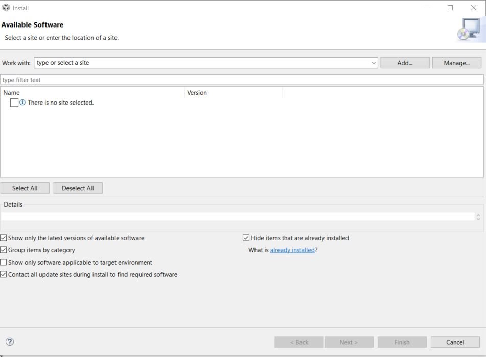

  • Hi Rahul,
    Is this your first time building an mmWave project with CCS? If so, we need to make sure you have the proper device support installed for mmWave devices.  In CCS, go to Help->Install New Software.  This will open a new dialog:
    Click already installed and check to see if you have "Mmwave Radar Device Support" installed:
    If this is not installed, you can install it in the install new software prompt from the previous step.  You will need the identifier com.ti.ccstudio.mmwaveradar.devicesupport.win32.feature.group
    Justin
