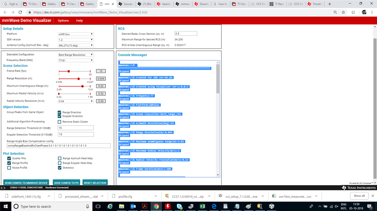

I am trying to do mmwave sdk 1642 demo, using mmwave demo visulaizer with sdk 1.2 adn tool box 1.6.2.
I am able to flash it using uniflash.But I am not able to get the plot since it is showing the error once it is loaded with configuration file.
pls help me to resolve this issue

  • Hi Karthik,
    Does this happen when you try to load a .cfg file manually using the load config button under the plots tab?
    Cheers,
    Akash
  • yes Akash..this error displayed on console when i load manually
    This happened when I I tried load confg from visualizer, but now when I repated the same thing, It shows HW connecetd but not showing any plot on the visualier.
    Kindly help me to resolve the issue, I tried with sdk1.2,2.0 but the effect is same.
    No console messages when I load config.
    My board is IWR1642BOOST rev A ES1 (no ES2 sticker on board)

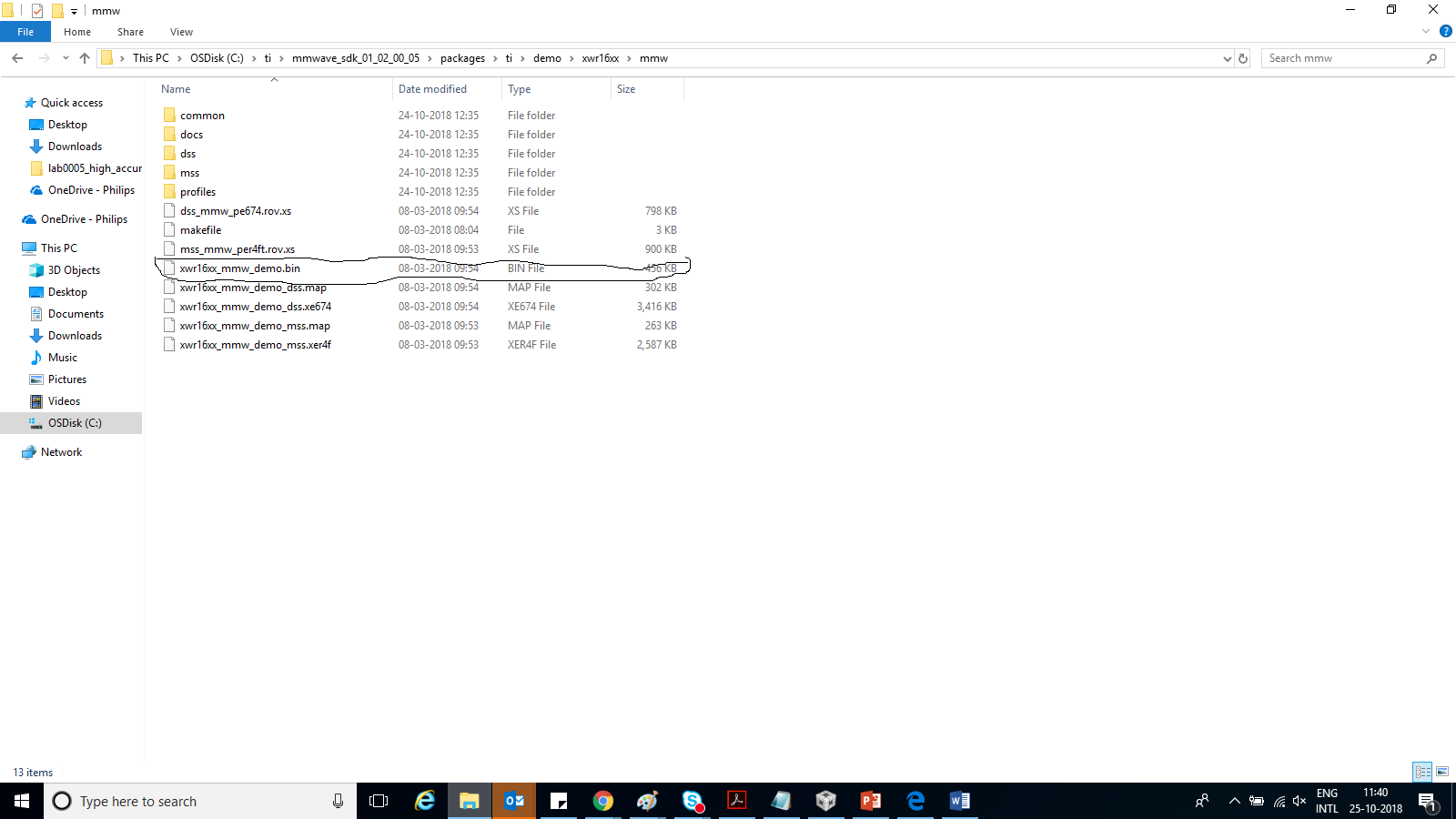

  • You need to flash it with the mmWave binary, not the CCS debug binary.
    Cheers,
    Akash
  • Hi, As shown in image, is it same file you mentioned in previous post? need to be loaded through Uniflash?
    Till now I was flashing from C:\ti\mmwave_sdk_01_02_00_05\packages\ti\utils\ccsdebug\ccsbebug.bin file as mentioned in the setup guide.
  • Correct you'll need to load it through uniflash and then try the visualizer again.
