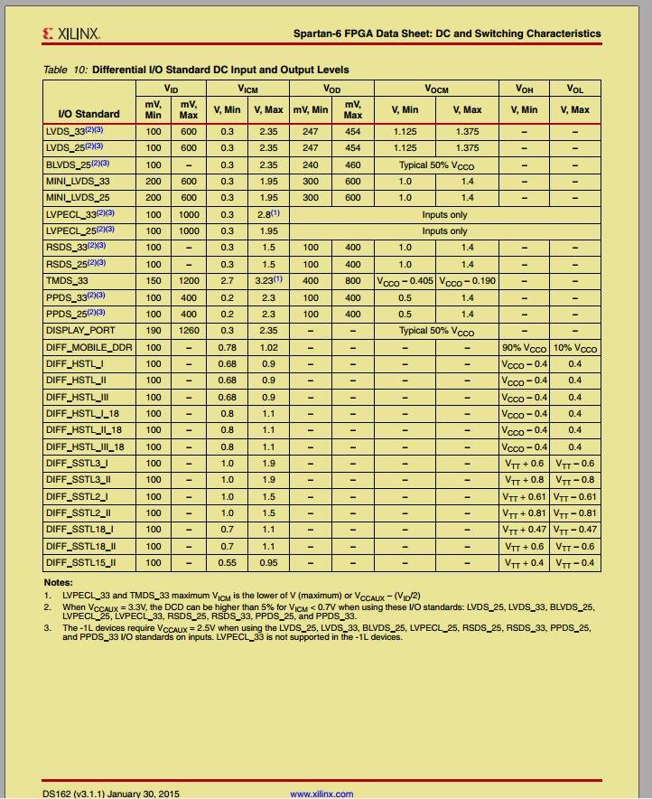

Hello, I want to get the ADC raw data from LVDS protocol, and send it to FPGA(xilinx Spartan-6),but I do not know how to set the I/O Standard of the FPGA ,which connect  to CSI2 Interface.
The xilinx Spartan-6 I/O Standard is below, what can I choose?  Is there any code demo for FPGA to read the ADC raw data ,thank you.
  • Hello ,
    We would recommending contacting the Xilinx support team to get the exact configuration needed on the Xilinx side.
    Our LVDs transmitter has the following electrical specs -
    Max of 900Mbps DDR rate.
    Offset or common mode voltage of 1125 to 1275 mV
    differential voltage (single ended) of 250 to 450 mV
