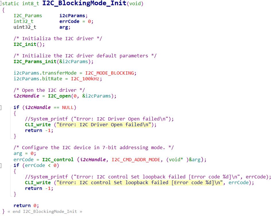

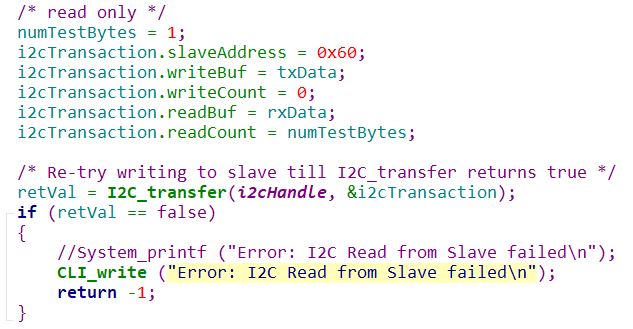

  • Hi Adrian
    Yes,
    I tried to the I2C example code, and implement the related function to mmw sdk.
    When I tried to read the LP87702-Q1 OTP_CODE, it received the wrong data.
    Is there any missing steps?
    Thanks.
    The initial code is as follows:
    The read data code is as follows:
  • Hi Kris,
    Please refer the code below:
    To read the PMIC version register. And the steps I have done are listed below:
    1. Pinmux initial
    2. i2cParams.transferMode = I2C_MODE_BLOCKING;
    3. arg = 0; errCode = I2C_control (i2cHandle, I2C_CMD_ADDR_MODE, (void* )&arg); //arg set to 0, and the I2C addr mode is 7-bit.
    4. To read the PMIC version register
    txData[0] = 0x01;// version register’s address in PMIC’s datasheet
    i2cTransaction.slaveAddress = 0x60;//PMIC’s address
    i2cTransaction.writeBuf = txData;
    i2cTransaction.writeCount = 1;//need to write the version register’s address to PMIC first
    i2cTransaction.readBuf = rxData;
    i2cTransaction.readCount = 1;//read the version register’s value(8bit)
    retVal = I2C_transfer(i2cHandle, &i2cTransaction); // read the register
    printf("version =0x%x\r\n", rxData[0]);//printf the result.
    5. To Write the PMIC register and set the buck3 output voltage to 2.0V
    txData[0] = 0x10; // buck3 output voltage register’s address in PMIC’s datasheet
    txData[1] = 0XC0; //default=0xca,2.3V. 0XC0=2.0V, buck3 output voltage register’s value
    i2cTransaction.writeCount = 2;//need to write the voltage register’s address first, then write the value
    i2cTransaction.readCount = 0;//it’s no need to read
    retVal = I2C_transfer(i2cHandle, &i2cTransaction); // write the register
    You can find more PMIC’s register details in PMIC’s datasheet.
