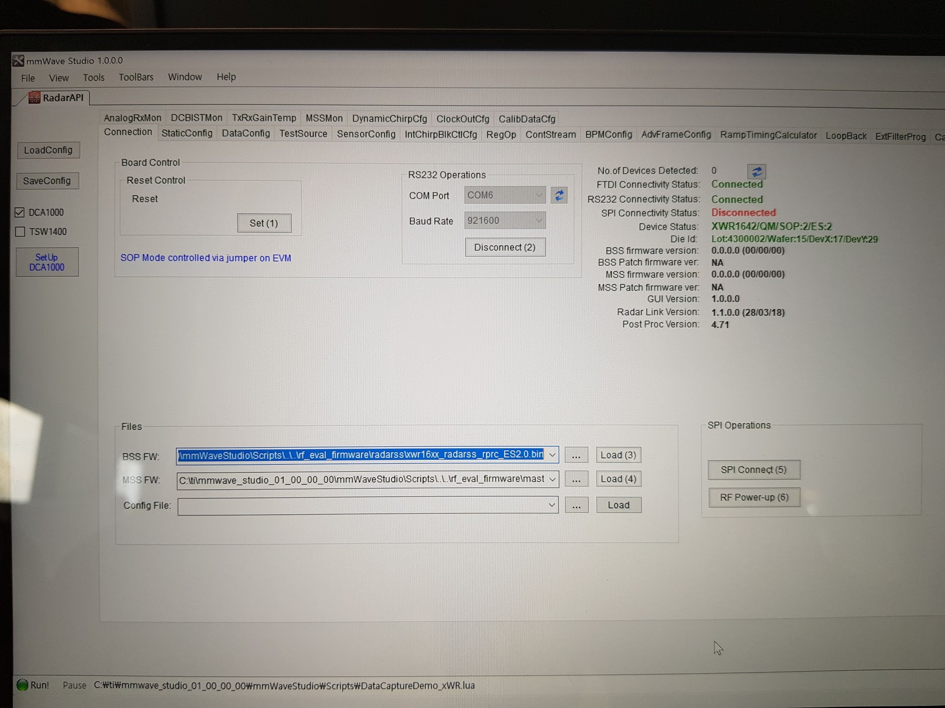

Dear, experts
Thanks to you all, i've enjoyed the device and its applications.
Today i received Data Capture Card which is called DCA1000EVM,
and faced a problem on SPI connectivity.
i removed the jumper on SOP2 and mounted the jumpers on SOP1, 0 perfectly.
also the Samtec cable is perfectly connected as well.
Thank you

    Can you provide more information so we can better understand the SPI connection issue you have posted here. At this point, there is very little information to go off to diagnose the issue.
    Please confirm the following physical setup:
    - 2 USB micro cables (one for IWR1642BOOST, one for DCA1000)
    - 2 power supplies (both 5V, 2.5A)
    - 1 ethernet cable
    Have you tried to click the "SPI Connect" button? What does the console window say when you click this button?
    Have you tried use the Capture Demo Script that comes with the mmWave Studio installation? Please refer to the DCA1000 Quick Start Guide here: www.ti.com/.../spruik7.pdf
    This guide details all of the steps, both hardware and software related, to get you started.

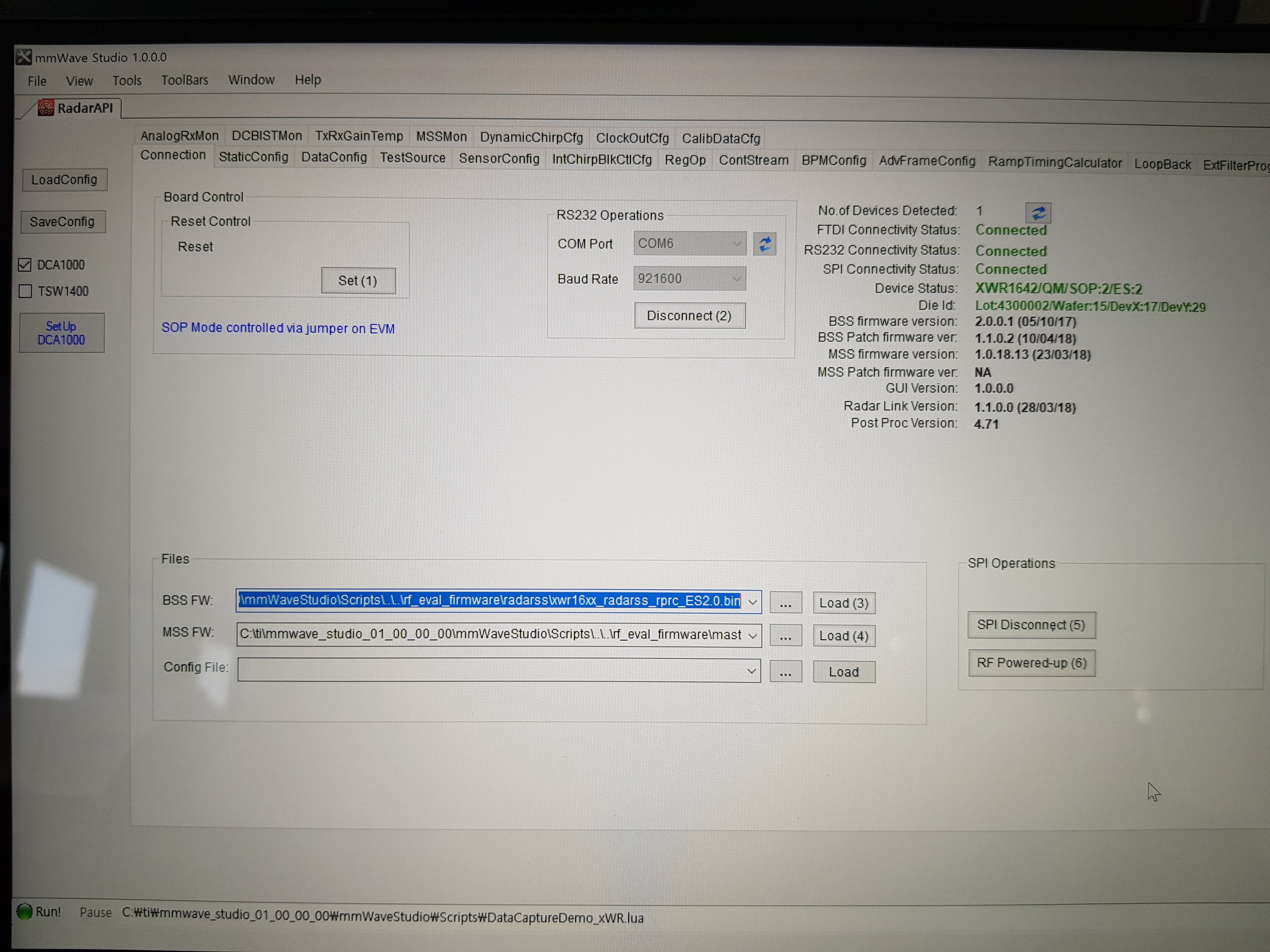

  • Hi Kyle,
    Thanks to you, i successfully connected SPI. Thank you very much.
    But the problem is i don't know how to do the next steps after it.

    Radar Studio was the predecessor to mmWave Studio. When the User's Guide refers to Radar Studio, you can use that term interchangeably with mmWave Studio.
    You should try using the Capture Demo Script that is shown in your screen shots. That script implements a capture and basic analysis of 8 frames of data. You can also look at the LUA script source code to understand the steps taken in mmWave Studio to configure the device and trigger a frame.
    With regards to the SOP modes, please refer to section 2.7.1 in the User's Guide for IWR1642BOOST. You can find the user's guide here: www.ti.com/.../swru521b.pdf

    i think i found out why it didn't work.
    it was because FPGA version was not read on mmwave studio even though everything was connected fine
