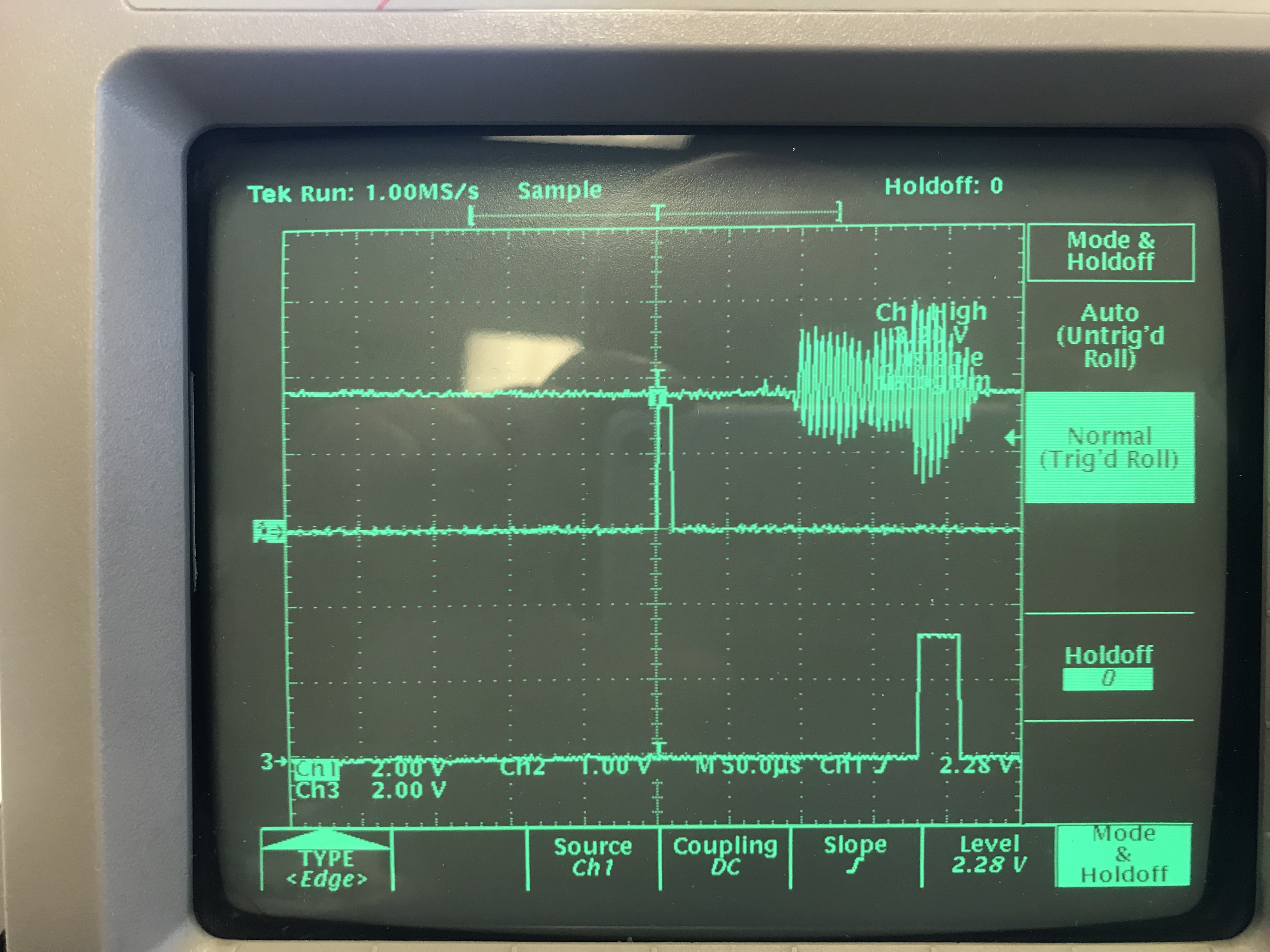

    Here's a scope photo of what I am getting with a 200kHz transducer. Keep in mind I've tried several transducers of different frequencies and get the same results. Top trace is comp, second trace is Start, and thrid trace is Stop.  I realize that Stop pulse is latching on to ringing but even if I blank that out using short ToF I still don't see a valid echo on comp. My range is only going to be roughly 1 foot. Suggestions please.
  • Mike,
    Please adjust your boost your COMP pin out data, the device could miss the COMP data since it is less than the VCOM value.
