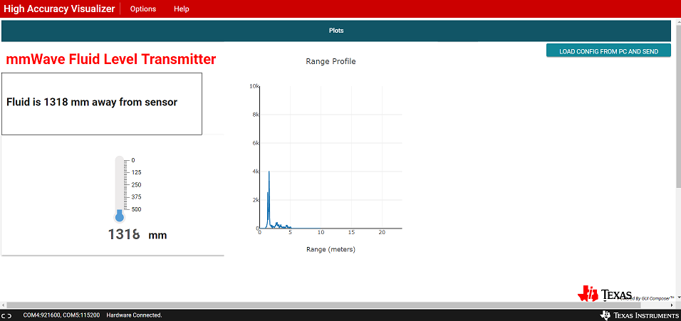

I have the High Accuracy Range Measurement Lab up and running, but I'm missing the radar controls on the Visualizer. Are they supposed to be there? My accuracy is way off.
About radar control, do you mean the config page as used in mmw demo? No, it's not in this visualizer.
As to your result, it may be related to the setup. Please make sure you have a high reflective surface object with no other objects around.
