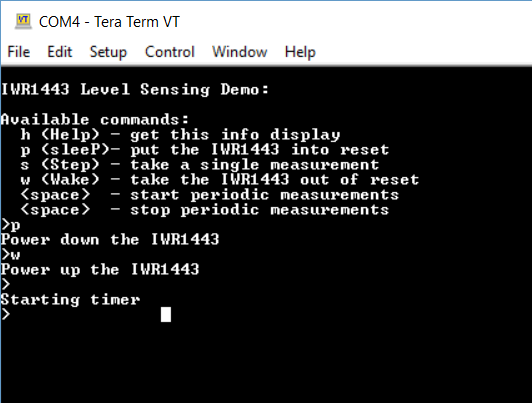

I recently got the TIDEP-0091 demo running on the MSP432 and the IWR1443. I can power on and off the IWR1443 just fine. However, whenever I try to take a single or continuous measurement, no data is being shown about the distances in the terminal window. It gets stuck after I enter a measurement command and does not allow me to enter another command. See picture below.
I added 0 ohm resistor R102 and R164, like the instructions mentioned to do. So I'm not sure what the problem is.

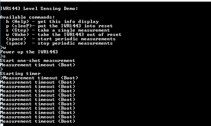

  • Akash,
    I have tried uncommenting that line and then rebuilding both demos for IWR1443 and MSP432. After that, I ran the demo and it printed out "measurement timeout" when I tried to take a measurement. But it still doesn't print out the distance data when I have that line uncommented which is weird.
    Kyle
  • Also, this is the output I get when I uncomment the "#define REPORT_IR14_TIME_MEASUREMENTS" line and try to take a measurement.

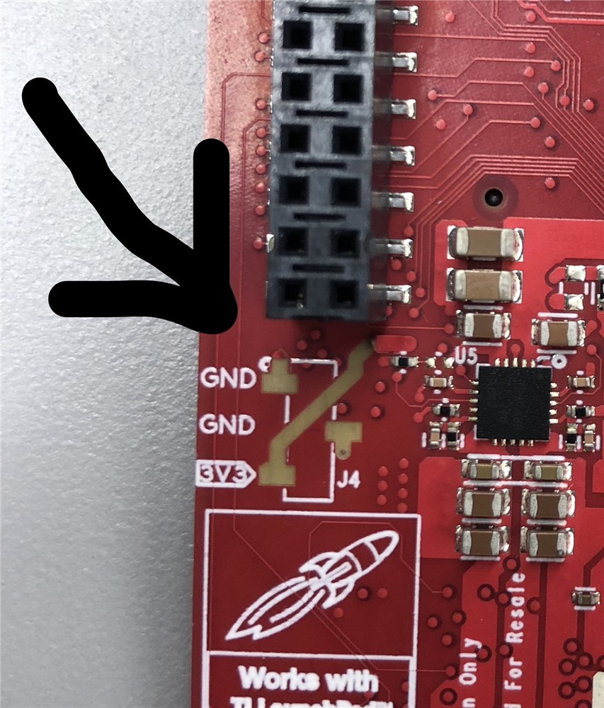

    4) When I mated the MSP432 and IWR1443, then removed the MSP432, it pulled off a trace on the IWR1443 on J4. I have included a picture. Will this be a problem with getting the distance outputs? I saw on the schematic that the trace connects to SOP0, so i'm hoping it won't affect the functioning of the level sense demo.

  • Hi Kyle,
    You should definitely get a new MSP432 Board at once. I cannot predict what kind of problems will occur when you have dislodged the trace of your power connector.
    You'll need to add both R162 and R9, both resistors are mandatory.

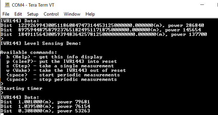

    So I realized that whenever I run the code and try to take a measurement, the MSP432 gets stuck in the SPI_data_transfer function and essentially is waiting for the IWR1443 to take a measurement and send its data (see the first picture I posted in this thread where MSP432 gets stuck). However, I found out that if I run the IWR1443 code through CCS while the MSP432 is stuck and waiting for the data, it will take a measurement and send data through SPI. So the issue is not with SPI, it is with the MSP432 telling the IWR1443 to take a measurement. See picture, the 2nd set of data.
