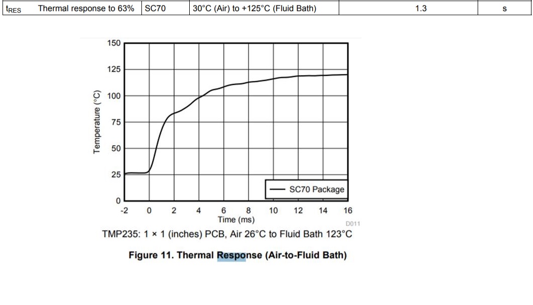

Question about thermal Response
Genius 4220 points
Part Number: TMP235
I'd like to know the thermal response spec of TMP235.
I found two data about a thermal response in TMP235 D/S as follows, but the time range of them are quite different from one another.
Which one is correct ?
And these data are for a condition of large temperature variation (around 100 degrees C),.
I guess that  the thermal response spec for a condition of small temperature variation (i.e. 5 degrees C) will be different.
Does anyone have any data of the thermal response spec for a condition of small temperature variation that I can refer to?
