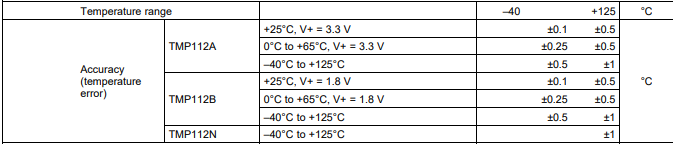

There are 3 types of TMP 112A, B, N.
The TMP112x divides the model name according to the accuracy test result.
I have some questions.
- Which of the 3 products is equivalent to TMP112?
- What is the maximum temperature accuracy when TMP 112 A is used at 1.8 V?
  Temperature accuracy maximum value = ± 0.5 ° C @ 3.3 V, 0 to 65 ° C. ± (3.3 V to 1.8 V) * (± 0.25 ° C.) = ± 0.875 ° C.
  Is this a wrong recognition that this is a guaranteed value?

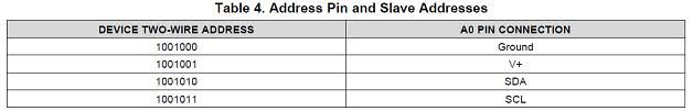

  • There are additional questions.
    Can I think that all slave addresses of TMP112A, TMP112B, TMP112N are the same specification?
    Best Regars.
    Noriaki
  • Hello Noriaki-san,
    You are correct, the TMP112x family is named according to accuracy, with TMP112A being designed for 3.3V, and TMP112B being designed for 1.8V.
    To answer your questions:
    All three are part of the TMP112 family, we could refer to any of them as a TMP112.
    Your accuracy calculation is correct, 0.25 °C/V is a guaranteed value. So you would not expect to see greater than 0.875 °C inaccuracy if using the TMP112A at 1.8V. Of course we would recommend using the TMP112B if operation at 1.8V is needed.
    - Can I think that all slave addresses of TMP112A, TMP112B, TMP112N are the same specification?
    Yes, all three devices will have the same address selection options.
