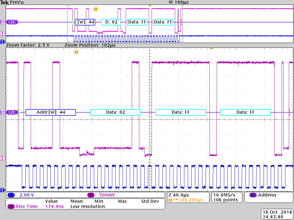

  • Here are a couple scope screenshots showing a write value of FFFFh to register 02h (low limit) and the following read back. This has been confirmed on 3 different boards. Additionally I have read the correct manufacturer ID and device ID, so I know I am talking to the correct device.

  • Hi, got more data! I've discovered that the 50 or so of these devices I'm using on instruments in the lab all have this issue and have always had this issue.
    Today I wanted to rule out any timing issues by decreasing the clock speed to 100kHz and lowering the I2C pullups to 511 Ohms to ensure rise times well with spec (didn't think rise times were a big deal with I2C but figured I'd rule it out anyway...). So with those changes I still have the same issue. But the added bonus is by probing close to the OPT3001 I can see if it's the master or the OPT3001 pulling the SDA line low. In the scope captures below the lower SDA signal means the OPT3001 is pulling down on it. In the second capture, which is the read back, you can see it looks like the OPT3001 is the one holding the SDA low during the transmission of the MSB during read back. I am all out of ideas at this point and could use some help. Thanks!

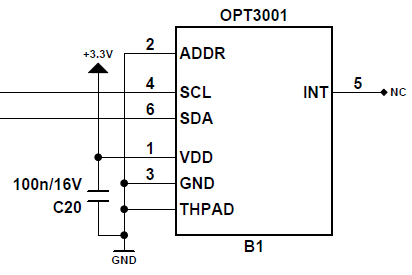

  • Hi Paul,
    I have not been able to replicate this problem on our EVM so far. Would you be able to provide the schematic of the board you are seeing this issue on? When you say the issue happens on 50 devices are they all using the same schematic or are these in different designs? Also did you manage to find an EVM for this chip and try with that? Narrowing down further will help me know what exactly to test on my end.
    Alex
  • Hi Alex,
    There's not much to the schematic; just 100nF decoupling cap on the 3.3V power and the I2C connections. Please see the image below. Additionally I probed the 3.3V across the decoupling cap with a short ground lead during read back and there's no measurable droop or glitches visible at 50mV per division.

  • Hi Paul,
    Do you know how I can replicate this problem? Did you try the EVM board on the same bus as the other devices or was it separate?
    Some more questions:
    From the schematic I was hoping to get an idea of what is on the bus and the pull up resistors. Are we able to say that the problem only happens on this bus with all the other devices? If so is it possible for you to start disconnecting the other devices until we get to a working state?
    Alex
  • Hi Alex,
    The pullup resistors are 1.6k and as I mentioned I reduced them to 511 to rule out any possible issues due to slow rise times. I suppose I could try pulling other devices off but I'm not seeing bad I2C waveforms. The other devices are 2 DAC121C085s and 1 ADS1115.
    Paul
