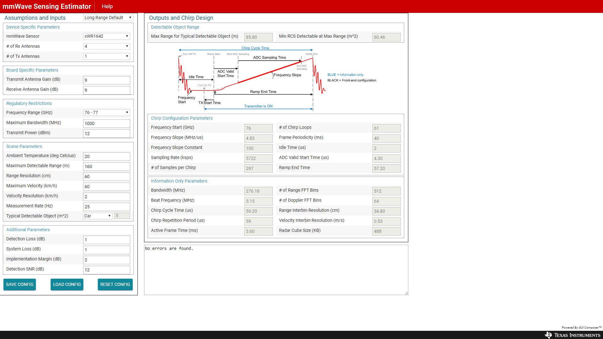

Hi Team,
Customer is using their own board(with high gain antenna) to run SRR demo, and now they can test 100m object well with 80m range configuration.
They wants to test it in 160m range.
Could you please provide a config which can detect object in 160m range?
I had recommended customer to use 120m configuration. Base on 120m configuration, I suggested him change the ADC sample rate from 5000 to 6250, and change the RX Gain from 44 to 48, and sloperate from 5.33 to 5.
Is this change suitable for 160m use case, did you have any other suggestion on the configration change?
Thanks for your help.
