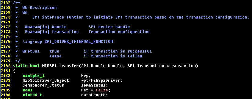

    Which mmWave SDK version are you using?  When I look at C:\ti\mmwave_sdk_01_02_00_05\packages\ti\drivers\spi\src\mibspi_dma.c I see the following which shows the MIBSPI_transfer() function with its opening brace starting on line 2181 (which would appear to match what you see when debugging).
    John

  • Kevin,
    Is it possible you have a different version of that file somewhere that CCS is using during debug?  When you hover the mouse over the filename do you see the correct path as shown in the following picture?
    John

  • Hi Kevin,
    I think I found the cause of the behavior you are seeing with the line numbers being different between the display in CCS and the line number that the debugger says the processor is on. The following thread explains it.
    e2e.ti.com/.../701754
    Windows files normally use CR-LF line breaks (carriage return character + line feed character) to separate one line from the next. There seem to be six carriage-return characters (0x0D in binary, "\r" in regex) without the matching linefeed character (0x0A in binary, "\n" in regex) in the mibspi_dma.c file. These six "incomplete" line breaks are being ignored by the compiler but are being used by the editor in CCS (which is based on Eclipse) thus causing the offset between the line numbers.
    I think the easiest/fastest way to resolve the issue would be as follows.
    1. In CCS with the mibspi_dma.c file open in the editor, execute the following menu option:
    File->Convert Line Delimiters To->Windows
    2. Re-build the SPI library
    3. Re-build the application which uses the library
    Afterward, the compiler and CCS editor behavior should be consistent.
    Please mark as answered if the issue is resolved or reply if more support is needed.
    John
  • Hi John,
    That fixed it for me and I am now able to debug. With the correct debugging I was able to determine that the transaction.slaveIndex was not properly initialized to 0 when I was trying to transmit more than 16 bytes. I have no idea why it was not being set correctly to the default but by explicitly setting it to 0 I can now send up to 64 bytes at a time.
