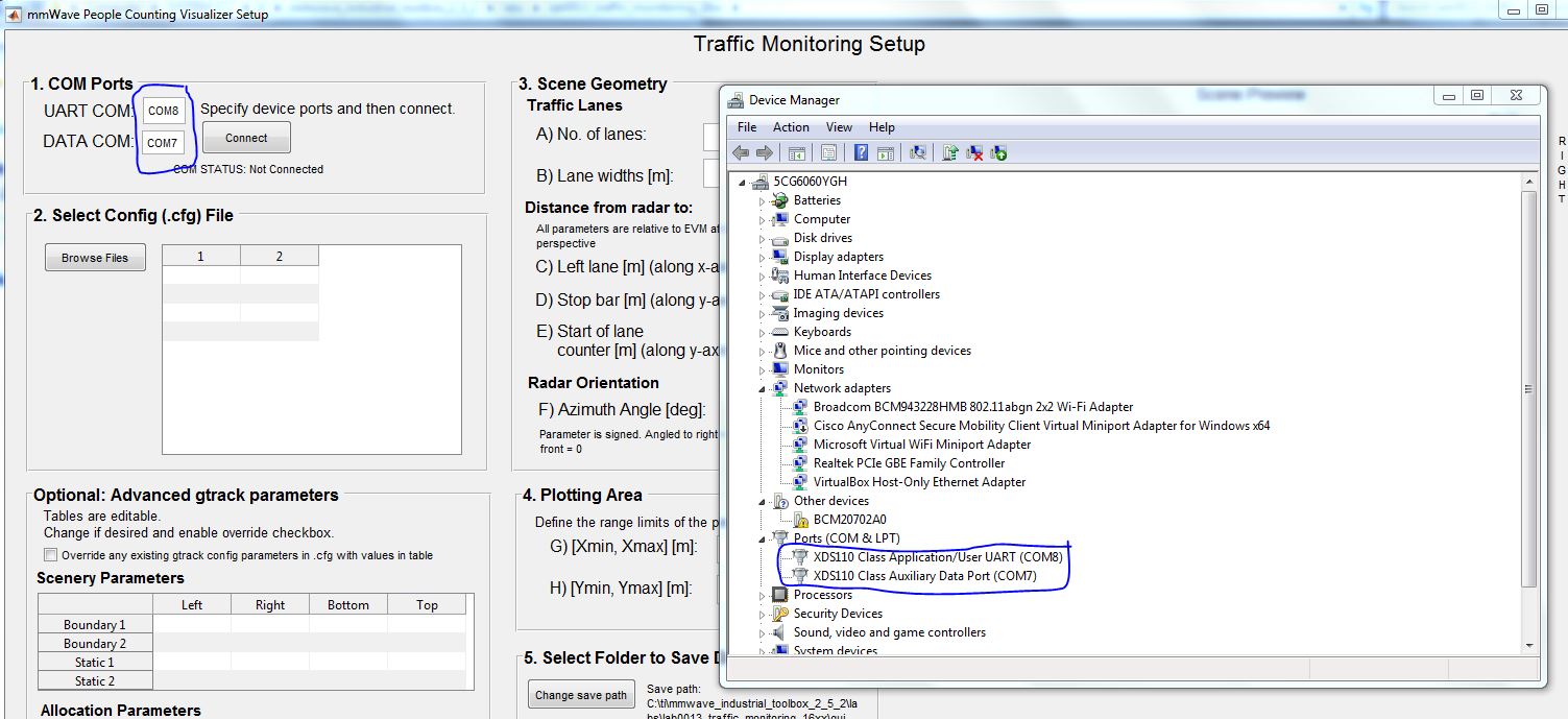

In Lab experiment traffic monitoring , COM ports are not getting connected. I am using Windows 7 on AMD A8 processor laptop.

    Please enter only the numbers and not the letters "COM". In the above example only enter 8 in the first box and 7 in the second.
