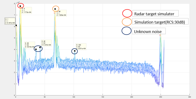

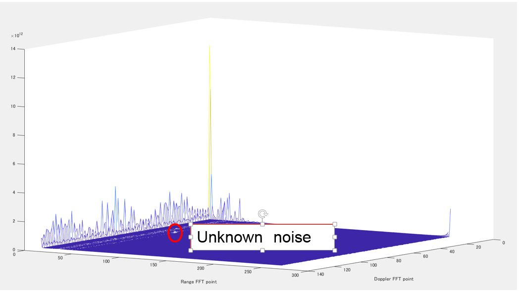

I'm using AWR1243P+TDA3.
I got AD data and processed FFT with matlab.
As a result ,unexplained noise occurred.
This noise has Doppler(Doppler peak:52) components in situations with only stationary objects. Furthermore, this noise is generated at a position shifted from the largest peak by about 34 points in the distance FFT direction.
What is the cause of this noise?
* Although this noise is quite small in MATLAB processing, it becomes large when processing with EVE of TDA 3, which has a big influence on target detection.

  • Measurement result in shield room
    M codes
    mat.zip

    >Does this spur change depending on target? Does the spur track with target distance?
     If there is a strong RCS target, it will occur at the corresponding position.
    >Can you please clarify what you meant by "Although this noise is quite small in MATLAB processing, it becomes large when processing with EVE of TDA3, which has a big influence on target detection."?
     Attach the image after TDA processing. Since the noise peak in this image is almost the same power as the target such as people, it is a problem.
     *Previously uploaded images were merely calculated absolute values of FFT, but this time we have converted (Using "mmwavelib_log2abs.c",void mmwavelib_log2Abs16()) and data of Rx 4ch and Tx 3ch (total of 12 channels) were added up.
    >Can you please specify your method of determining that this noise is "a big influence".
     We want to detect the iron mass, people and road surface with radar. In that case, the RCS difference may occur between 20 and 30 dB. Therefore, generation of this noise is regarded as a problem.
     * In particular, we think that this noise has a power equivalent to that of the low RCS, so it is a big problem.

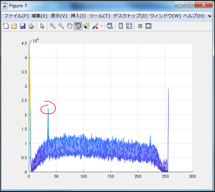

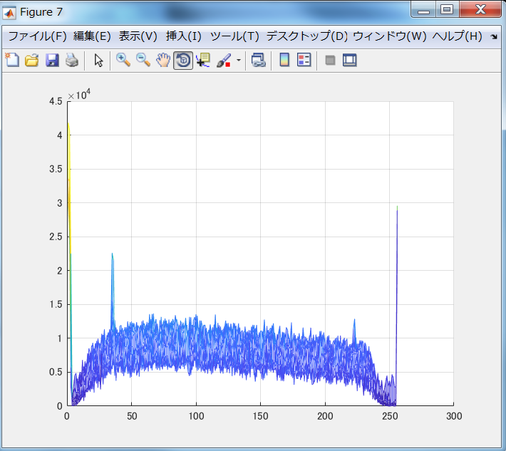

    >What kind of noise floor and spurs does your sensor see in the radar testing shield room with no target present?
    Upload measurement result of shielded room without target.
    thanks and regards,
    Takahashi
    Result of no target in the Shield room.(Processed EVE)

  • Hi Takahashi,
    Any change in the status of this issue on your side?
    Just to confirm, does this spur in the no target noise floor image correspond to the unknown noise source you are tracking? Can you attach this no target dataset as well?
    If this is the noise you are tracking, then with no target, the only sources left are sources on the PCB itself.

  • Hello Randy,
    I list the answer to your question.
    First, we will send you the AD data measured in the shielded room without the target.
    Confirm with each person in charge about PCB check and other pointed out contents.
    Thanks and regards,
    Takahashi
    ad-20181109-121141.zip
