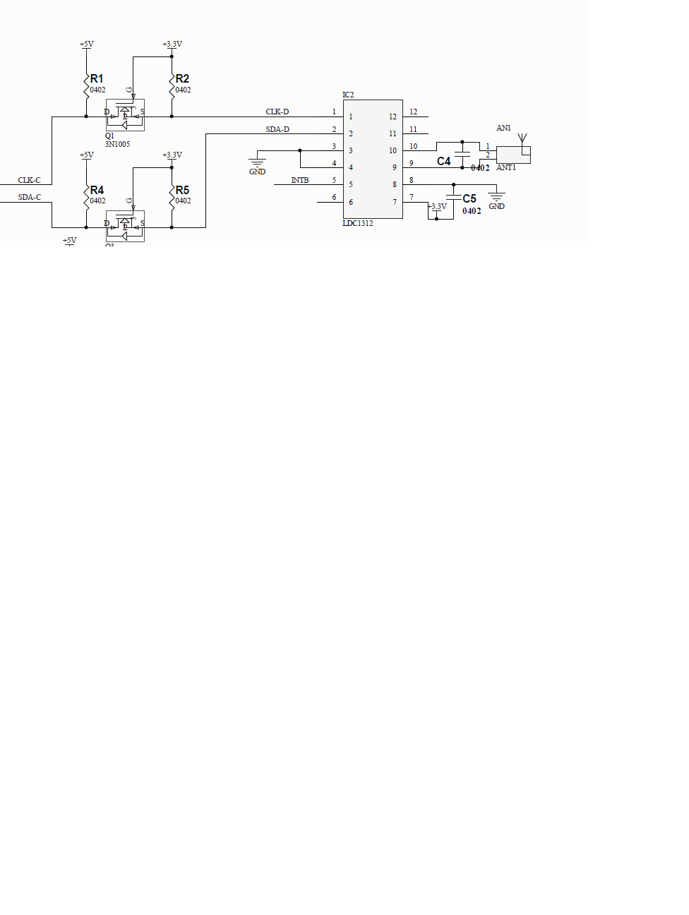

The LDC scheme is
GERBER FOR BIN-COIL-REV2.rar

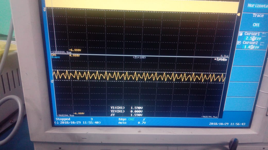

  •  Please find attached the waveform at InxA pin with respect to  ground
  • I have adjusted the current drive. Below is snap of waveform after correction.

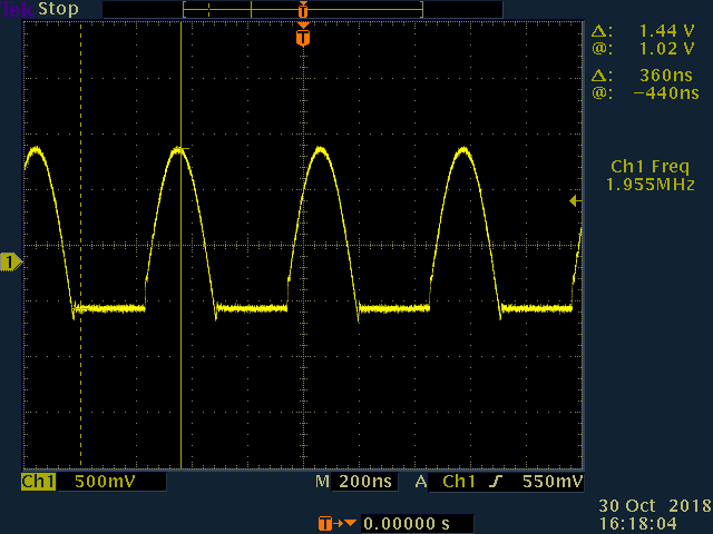

                             Your voltage level seems fine. But, the waveform shape is not good. Please find below the waveform from "INx" pin. Probing either INxA or INxB with respect to ground should yield a half-rectified sine wave, where the rectified part is at 0V and the remaining sine portion is positive.
    If the sensor is being driven incorrectly this could certainly yield poor sensitivity or large swings in the output codes. Can you please provide us a picture of the setup? If you feel its confidential information, you can email it to me at: b-ravi@ti.com. Also what type of capacitors are you using? We recommend COG capacitors because of their low drift due to temperature and applied voltage. Can you please verify if the coil resistance data provided is for Rs or Rp? It would make sense if it is Rs.

  •  i had tried with different current drive setting,but found no improvement in waveform. Replaced the current 18pf capacitor with 220 pf and found following wave form.Is it normal expected waveform.
  • Hi Shrikant,
    When you measure the "INx" pins, it should look something similar to the waveform I shared with you earlier. Can you scale your horizontal axis to sample more points? For example, if you're currently measuring 10us/div, increase your sample rate 10x to 1us/div. Its good that you're trying different capacitor values. Can you try something close to 100pf, also make sure you try a COG capacitor this time. Changing cap value will decrease your resonant frequency. How thick is your target? Because the skin depth increases as the resonant frequency decreases. And your target needs to be at least 3 times the skin depth. You can check this by plugging in numbers to the excel sheet I shared with you earlier. I received your setup picture, would it be possible to place another sensor to right of the target? Or would it be possible to have a sensor coil on side of the PCB shielded to the target (this sensor can help us get rid of change due to temperature drift). Finally, if your application requires multiple LDC1312s to read similar output codes, you need to use a clean external clock. From datasheet table 6.5, internal ref clock ranges from 35MHz to 55MHz (typical value of 43.4MHz), due to this variation the output codes will be different for different units.
