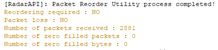

    If you notice packet loss, increase the Packet Delay.
    You can see the details (if any packets are lost) after you press the PostProc button in mmWave studio ->SensorConfig->Capture and Post Processing. (Sample below)
    Let me know if you have any doubts.
