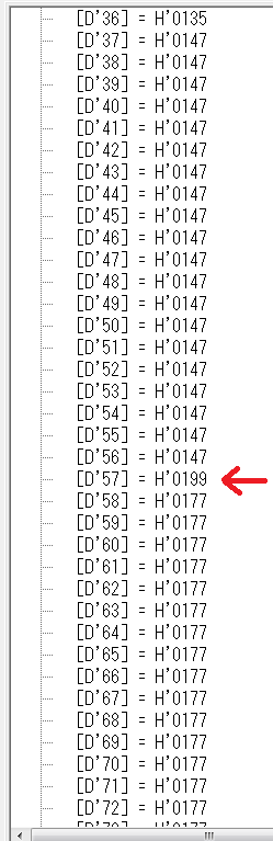

One of my customers found an inconsistent read out from result register like shown in the below picture.
The frequency of data reading here is 40ms where the conversion mode is 800ms. Thus, the device should return the same data for 20 readings, but somehow just one data is different in a transition of light level.
Similar thing is also found in start up of the device. For 800ms of power-on the read out should be all 00, but the customer sometimes sees 00FF and FF00.
Do you have any idea what causes this?
